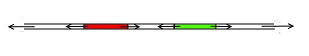

I'm having some very basic conceptual problems about tension. If you have a pulley where two masses are hanging on opposite ends of an ideal string, why is the upwards force that the one mass experiences the same as the upwards force that the other experiences? People have tried to explain this to me by saying that it's logical because it's the same string and it's massless, but I just don't get it. What I DO get is: (a) that the acceleration of the masses will be the same and (b) that if the masses are equal, they will be in equilibrium, and the tension will be equal to the weight. Is there perhaps a more mathematical answer to my original question (e.g. reciprocity or something?) Also, exactly how is tension defined? Is it by definition a scalar quantity, or is it a vector? If it's a vector, how is the direction defined?
Tension is a type of force. As a force, it has the properties of a vector, i.e., magnitude and direction. Strings by nature can carry only tension (you can't push a string). The direction of the tension will therefore act along the length of the string.
Tension is what makes tug of war. In your example, the string is draped over a pulley, and both masses are tugging at each other. If you want to know why the tension is the same in both parts of the string, draw a free body diagram of each mass. What forces act on each mass?
Think about two little bits of the string in the middle somewhere. Each bit is subject to forces on it's ends.
The total force on the red bit must be the same as the green bit or one would accelerate toward or away from the other either stretching or compressing the rope. If the rope were stretched or compressed the forces would change restoring the balance.
Consider what happens if the two bits of rope are at the ends.

I'm going to latch onto the picture of the string that CWatters attached, because it looks as if it could be useful, and I like visual representations. (We haven't done tensors yet, but it looks like a good explanation and I'll definitely come back to it.) I understand that the net force on each bit of string must be the same, otherwise the string as an entirety would compress or stretch. That makes sense. So, say each of the coloured bits were at an end of a piece of string with masses attached (say with weights 5N and 3N respectively) hanging over a pulley wheel as I described. The downwards force the first bit of string experiences would be 5N, and 3N downwards for the second bit. The first bit would then have to experience a 3N upwards force, and 5N upwards for the second in order for the net force on each bit to be the same (looking at the direction of the forces from left to right along the string, rather than up and down). Is this correct? What in this situation would represent tension?
The tension T throughout the string would be uniform, including at the ends. Call it T. Now do a force balance on each of the two masses as a free body. This will result in two equations in two unknowns, the string tension T, and the acceleration of both masses a. Solve for T and a.

You can imagine the string as a stretched spring. If you select a piece of it as shown in the picture, the other parts act at the ends with forces T1 and T2: These are the tensions in the string at the positions of the ends of the selected piece. If the string has mass, and the mass of the piece is m, the piece will accelerate with a=(T1-T2)/m. If the string is massless, the smallest difference of tension at both ends would cause infinite acceleration. So the tension must be the same everywhere in a massless spring.

Here is another way of saying what Echild said. Imagine a straight string, with a tension T1 on one end and a tension T2 on the other end. If the mass of the string is m, a force balance on the string gives:
T1 - T2 = ma
As the mass of the string approaches zero, the difference between T1 and T2 approaches zero, irrespective of the acceleration.
