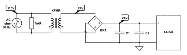

So a typically "HVAC" transformer will be from Line to some lower ( often control voltage) - but I would agree the High side of transformers probably do have a higher failure rate:
1) Higher voltage stress on the insulation. The insulation on the high side will typically be closer to the "spec" - for example a 480 VAC primary, will be 600V Class... guess what the insulation class of a 120/240 LV side is? Typically still 600V... Even for control power transformers, like 24V - there will be a lot of margin in the insulation since there is little savings in using the minimum.
1A ) Affect of line disturbances on the primary windings. All of the disturbances coming in the facility from the utility connection, switching events, lightning, voltage dips & the associated recovery, and then even just the turning on and off of the transformer locally, stress the primary windings much more than the secondary. ( Both result in both over voltage and higher frequency elements)
2) Overloading - will cause the overall unit to heat up, what does heat do to a transformer do? It ages the insulation faster. But there can definitely some hot-spot issues that can occur on the LV side - I^2*R type issues, become more prevalent if the unit is frequently overloaded, or it was marginally sized. ( Also note - as the low side leads to much of the heating, the windings are often built with a little better spacing, for cooling, but this also helps reduce insulation stress - I have seen secondary faults become re-energized and "live" - but never a primary.)
But.. this leads many lay-persons astray... a majority of these issues lead to insulation failure, leading many to "blame" the insulation, the transformer, and thus the manufacturer. But a lot of the stress can be outside of the design parameters, or the transformer is not applied or protected properly. Still - in a mass produced consumer / commercial products like HVAC transformer, I'll bet your customer knows some brands that fail more frequently than others...
The question for him is -- when he has to replace a transformer, does he use the better brand - or the lesser one for "job security"?? (;-)

The transformer is also the front end interface to the power grid. The transformer helps to filter spikes protecting the rest of the circuitry on the low side.
