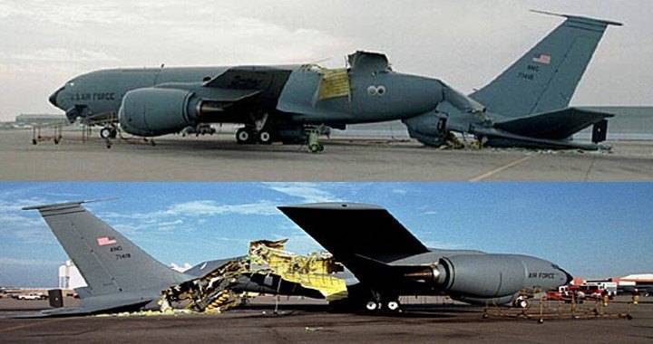

A bit late, but something to add to the discussion here as an A&P...
All pressurized aircraft have a design limit to the pressure differential between the inside and the outside, usually shortened to the phrase "delta P". To ensure the pressurization system never exceeds this limit, there's a pressure-driven portion of the cabin pressurization controller that will actuate at a certain point just under the design limit. Even within a manufacturer's family of designs, like the Cessna Citations for example, that precise value will vary from design to design. For the Citations, that can be anywhere from 8.3 psi on the smaller birds like the Mustang and the CJs, all the way up to 9.3 on the Citation X. The outflow valve(s) that manage cabin pressure can sense the delta P, and will open up rather abruptly if you attempt to overpressurize the cabin. These valves are checked regularly during scheduled inspection to ensure they work properly. Sometimes, they don't, usually because of damage, like a mouse deciding to nibble its way through the diaphragm of the valve to get into the contents of the snack bar!
And it's absolutely possible to overpressurize the plane if you disable those safety valves... as a maintenance crew working on a KC-135R found out the hard way 20ish years ago:
  • Wow
