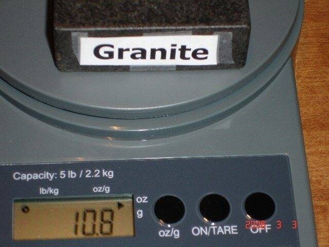

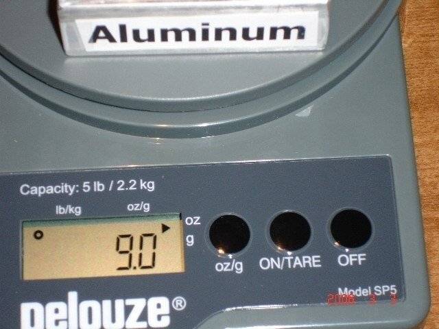

Seriously...Granite is 2% heavier than aluminum and takes considerably more time to change with ambient temperature. I value your input. all suggestions welcome.

Actually the reason for asking is more mundane and a lot less enjoyable than drinking beer. I sell Cmms. Coordinate Measuring Machines. These are X,Y and Z axis servo driven machines of the traditional bridge design. Since invented in 1959 these Cmms have been made with granite. Almost all Cmms made today still use a granite table for the base. But unlike the ones I sell, todays competitors use aluminum or ceramic coated aluminum for the bridge and Z axis quill. From strictly a marketing point of view the reason for asking why we don’t make beer cans from granite could be answered with” for the same reason new don’t make gage blocks from Aluminum”.
The only advantage of using aluminum is that it weighs 2% less than granite. The air bearings on an aluminum Cmm are held on using Belleville cone washers. This , to me, is not a good method for the long term due to cyclical failure. They are used to counter thermal expansion which is a real problem for the aluminum bridge and Z axis as these are covered with bellows to keep the machined ways clean. The DC motors under these covers generate heat. And aluminum does not like heat. In fact , the scales must be mounted to stainless steel scale mounts and these are bolted on the aluminum structure on one end and the scale housing “Floats”. On my granite Cmms the scales are taped on to the hand lapped granite itself.
The major marketing ploy my competition uses is the CMM maximum acceleration of 1200 mm/sec. My CMM max acceleration is 800 mm/second. They tout the faster speed means higher thru put of measurement. Strictly bogus bunk since no one measures the apart at that speed.
My countering points are that granite Cmms accuracy comes from quality of components and quality of assembly. All Cmms have 21 errors of geometry . Flatness, straightness, Squareness yaw, pitch and roll and scale count in XYZ axis = 21. These errors are resolved by hand lapping or computer compensation. Granite Cmms are intrinsically accurate and the only compensation is to calibrate the scale count to true linearity with a laser interferometer. The Squareness is compensated as well (this is a static compensation). All other parameters are hand lapped to make the CMM intrinsically accurate. Granite cmms end up having volumetric accuracy of 2 to 3 micron uncertainty.
Aluminum Cmms use a computer error map to provide accuracy. The volumetric accuracy without the error map would be 50 micron. They market the compensated accuracy as the same as granite cmms.
Hence my odd questions these past year about digital scales, Belleville washers and granite beer cans..
You can roll aluminium into a very thin sheet. When you roll granite you end up with a gravel roadway made from crushed rock.
Thermal conduction and tensile stregth of Al is far greater than granite. If you place Al in direct sunlight, it does not fracture or exfoliate like granite subjected to daily heating and cooling cycles.
Al is homogeneous. Granite is characterised by very large grains of quarts, feldspar and mica. Rhyolite is a volcanic rock with the same composition, but with a much finer grain. If you built beer containers from rhyolite you end up with an opaque glass bottle.
Good points all, from the Master!
I would add that because Al is homogeneous it makes for a noisier CMM as at some point it has resonance. It becomes a tuning fork. Because Granite has varying content of mica it is naturally sound deadening and makes for the quietest drive train operation when measuring. One nice thing about granite is modulus of eleasticity is nil and it will fracture when excess load is applied. Al flexes and is springy. Accuracy and repeatability of measurement to the micron requires stiff structure that does not flex or distort.
Finally, test s show that it takes 8 hours for granite to grow thermally..not so with AL.
It is also cheaper, much easier to work, and more durable. That would reduce the price of manufacturing a CMM and the cost of maintenance over the life of the machine. It's strength to weight ratio is also substantially higher, though that wouldn't mean much for a CMM.

My reason for this question is to develop features and benefits traditional granite vs aluminum in Cmms. The obsurd granite beer can was to generate exactly whet it did..great points all.
i think i am off on the % weight difference..ooops
