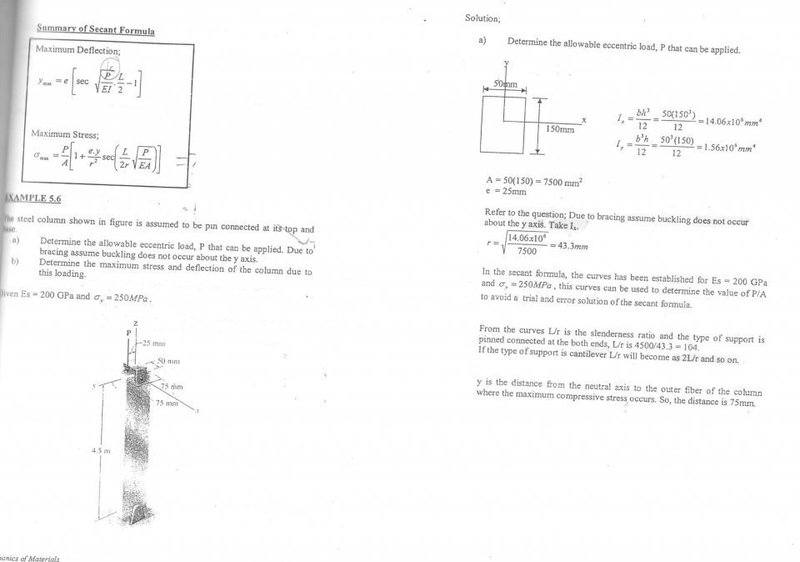

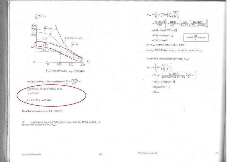

in this question , ( in second photo) i don't understand that why at eccentricity ratio = 1 , P/ A is 83kPA , why the vertical line is drawn at a point between 100 and 150 KL/r to find P/A ?
Is it wrong ? Or I left out something? [/B]

The vertical line is drawn at the given kl/r of 104.

How do we know that kl /r =104??
