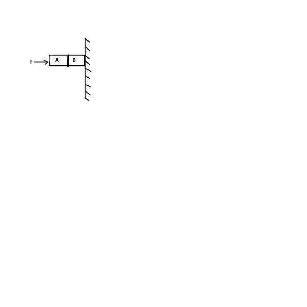

;Given in the figure are two blocks A and B of weight 20 N and 100 N, respectively. These are being pressed against a wall by a force F as shown. If the coefficient of friction between the blocks is 0.1 and between block B and the wall is 0.15, the frictional force applied by the wall on block B is

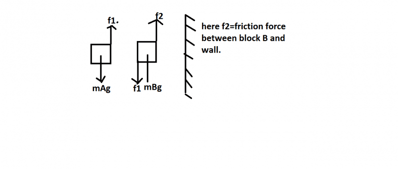

f 1(static friction force acting on block A)=20 N=mass of A multiplied by g.
Here f 2=f1+ m g B= 120 N
The only thing I don't understand is why f1 is acting on block B?[/B]
View attachment 81959 [/B]
:View attachment 81960
Because action and reaction are equal and opposite. If B is exerting a force f1 up on A, A must be exerting a force of the same magnitude down on B.
But ,f1 is not exerted by A alone,it's a force of friction.It is due to contact between both A and B.Newton's third law will be applicable here also?
gracy said:
But ,f1 is not exerted by A alone,it's a friction force.It is due to contact between both A and B.Newton's third law will be applicable here also?
As far as A is concerned, it is just an external force exerted on it. Doesn't matter whether it's friction or, or a nail, or magnetic...
Similarly for B. Yes the action and reaction law applies.

Then f 1(static friction force acting on block A) should also be =f2 +mA multiplied by g
But if it is true we will not get the same answer for f2 i.e 120N.
Why?
For the same reason i.e Newton's third law.
Show your work. Why does Newton's third law require that f2 = f1 + mAg?
Because of Newton's third law f2 will also act on block A But in downward direction because f2 is acting on B upward.So for equilibrium of block A.
So f1=f2+mA g
So f1=f2+mA g
That is a completely incorrect understanding of Newton's third law. F2 acts between block B and on the wall. It does not act on block A at all.
Oh,sorry.I misunderstood f2.My bad.I thought f2 is force of friction between the two blocks experienced by Block A.
I labeled that f2 =friction between wall and block B but forgot.Really sorry.
Even this is wrong.But now I am clear .I know force of friction between the two blocks experienced by Block A is f1 acting in downward direction.
