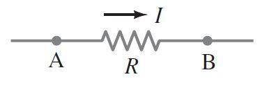

Why is the current the same at points A and B in a resistor?
  • Level: High School
  • Thread starter Thread starter skepticwulf
    Conservation Current
43 replies · 6K views · last reply
skepticwulf
74
In an explanation of a textbook's diagram it says : "Conservation of charge requires that whatever charge flows into the resistor at point A, an equal amount of charge emerges at point B. Charge or current does not get “used up” by a resistor. So the current is the same at A and B. "
I can understand the conservation of charge but isn't current = charge divided by time?
Wouldn't the resistor SLOW the charge move, isn't the reason we use them in the first place?
So, how come the current is the same at A and B? I'd expect at B the current would be less as resistor would limit the charge passing through itself over time t ?
What do you mean by "SLOW"? Are you confusing distance by time with charge by time?
I mean charge by time. Wouldn't resistor change the amount of charge transferred in seconds?
"So the current is the same at A and B" means charge per time is equal at each point, doesn't it? How could that be? What's a resistor for then?
Change compared to what? To without the resistor, yes. But the current must be the same at both ends of the resistor, because charge cannot accumulate in the resistor.
It resists the flow, so you need more voltage for the same current.
But the voltage is not the same. If it was why would electrons flow from A to B?
At B voltage is lower, R is the same how come I-current is not changed??
Am I missing something here?
I know Voltage and current are different things but I just don't get why current at B is same with A, sorry maybe I'm too thick.
I need to read similar topics and do a further search and then go on.
Thanks anyway.
To make a crude analogy, consider a stream of cars on a highway, moving at 100 km/h. As they enter a town, they slow down to 50 km/h. As they leave, they speed up again to 100 km/h. None of the cars "vanish" inside the town.
Another analogy, that I like better than jtbell's, and I'll explain why, is that current is exactly like a bicycle chain. It has to move at exactly the same rate at all points in a simple circuit loop. Think of it as the power source pulling on the bottom end of the chain, forcing it to circulate evenly all around the circuit.
The reason I like this better than jtbell's analogy (not at all that his is wrong in any way) is that his might be mistakenly interpreted as implying that the cars outside the town are still going 100mph while the ones in the town are going 50mph. This is not possible.

It is in fact possible.
Current is a "count" of electrons per unit time.
Although the speed of the individual cars traveling through town may be lower than on the highway, there are more paths, and hence, the number of cars entering, passing through, and exiting the town would be the same.
Perhaps we need fourth analogy! "Ticket counters at a football stadium"
Now, the ticket counters would be the opposite of resistance, as each counter can admit one fan per second.
So the flow of fans into the stadium would be the reciprocal of the number of counters.
But the flow of fans before and after the counters, would be the same.
Because there is potential difference between points A and B, the work of electric field is not zero between these two points and it would accelerate the electrons but the resistor keeps the velocity about the same by converting the work of electric field to heat (via collisions of electrons with the conductor atoms).
I prefer a water analogy because the above analogies each only discuss one flow scenario, whereas the OP appears confused about the relationship between two different ones.
Say you have a large tank with a small pipe coning out the bottom, with a valve in it that is all the way open. This is like a wire with no resistors. The flow rate (x GPM) is the same in the entire pipe.
Now close the valve most of the way. This is like installing a resistor in the wire. Now the flow is lower (perhaps 0.5x GPM), but as before it is the same everywhere in the pipe.

Thank you for all the replies.
What I'm stuck at is this:
Suppose 5 Columb of charge pass at A in 1 sec. The current is 5 Ampere.
Inside the resistor electrons will "slow down", they will not be able to pass the resistor like they did before A inside the conductor.
Now reaching B, less electrons will pass in 1 sec. Number of electrons passing B will be reduced. That's like squeezing the garden hose. So it is no longer 5 coloumbs per second but less, say it's 4.
So the current is now 4 Ampere.
So the current has reduced to 4 from 5.
What's wrong with this picture, that's what I'm trying to comprehend.

Don't try to think of current in terms of the velocity of the charges. It's not a good way to look at it and will only confuse you.

because you are thinking that the flow is reduced ONLY in the resistor, this is a common and incorrect understanding
The presence of the resistor reduces the flow in the WHOLE circuit, not just through the resistor
