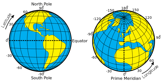

Values of ø between from 0 to π cover the whole surface of the sphere. On maps of the Earth latitude is measured from -90 to + 90 degrees not 0 and 180, and longitude from -180 to +180 not 0 to 360, but the basic idea is the same.

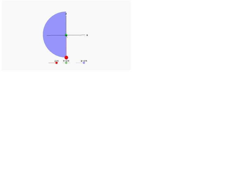

Okay, I have uploaded two attachments.
When I view from side, ø = π, covers only half the circle (see the picture). When I try to think of it as a clock, ø = π, covers 12 to 6. Now shouldn't ø = 1.5π cover 12 to 9, and ø = 2π cover the whole circle, and reach the same point as π = 0.
Also, in ø = π, the 3d section appears to me as a hemisphere. Shouldn't it be a total sphere??
Or maybe, I am confusing spherical coordinates with polar or cartesian coordinates??
So what you have shown is a coloured half-disk. For every point on that disk, Θ = 0. If you vary Θ from 0 to 2π the half-disk will sweep out a complete sphere.

EDIT: Okay, I think, I got a little idea of why ø = π would work. Basically, The up and down thing was exactly right. I think, I confused myself, when I added a sense of left and right. It is a total different axis, and the coordinates seem to do exactly the same thing, by putting θ = π to 2π.

Phi is the angle between the axis of the sphere and a line drawn through the center of the sphere to a given latitude, measured from the North Pole. It is equal to 90 degrees (i.e., ∏/2) minus the latitude. So, ø =0 represents a line drawn from the center of the sphere through the North pole, ø = ∏/2 represents a line drawn through the center of the sphere to any point on the equator, and ø =∏ represents a line drawn through the center of the sphere to the South pole.
