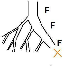

You're missing the point. Your results are only one path in the bifurcated tree. You have no idea where your particular history resides in the tree because you only have access to your single history.
  • #95
I don't see how is that different from say, your position in the spatial dimension. You only have access to the single position, yet that doesn't stop you from using symmetries, homogeneity or isotropy.
