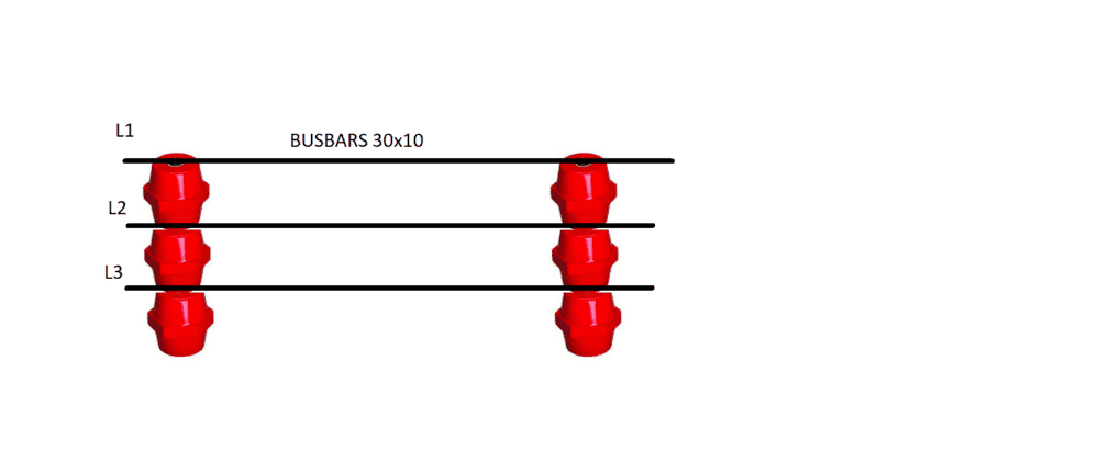

Why it's not a practice to use such busbar spacing insulator arrangement as it's showed in the picture from attachment (one busbar above other)?

Your question is SERIOUSLY lacking in information, but who says it isn't?
How would you put out the fires that start in the animal nests built between the bars when the power is off?

This is used - it has been a while but I am thinking often in MCC or other lower power - or more importantly lower fault current applications. The mechanical strength of the bus is almost entirely determined by the fault current stress.

You can everywhere buy horizontal, vertical or stair type of busbar insulators, but nowhere something like that. I guess that those red insulators have low mechanical strenght in regards to short circuit power between two bars. I asked it because I always see three phases placed horizontaly with some spacing between phases, but never seen one above other..

Yeah of course. In that case, can you give explanation why we can use one busbar above other or why we can't. Is insulator's strenght too week for this type of arangement or not?
Convection cooling is improved by mounting the bars on their sides. Better cooling reduces the need for copper and support for that mass.
A bar must support it's weight between insulators, there is less sag when mounted on edge than when flat.
The insulators are subjected to less voltage where the bars are supported from a grounded chassis. Leakage or voltage breakdown should be to ground, not to another phase.
Bus bars come in limited lengths, they must be joined. Also, how do you make a tap to the bus if you cannot inter-finger one bar between two at the same potential?
Threading a bar into the support structure, or installing an insulator, should not require disturbance of other bars.
Sometimes the coded standards are based on what worked 50 years ago. If that standard does not include a particular configuration, then it cannot be used.
There are many practical and electrical reasons why the use of some particular configuration is unusual. How many other reasons do you need?

The insulators you show in post #1 have an internal thread at each end. You must tighten the screw with a spanner, without rotating or damaging the insulator. Where two insulators meet at a bar you will need a short threaded stud. But that cannot be tightened without gripping and risking damage to the insulator surfaces while overcoming the friction between the bus bar and the radius of the insulator end. Staggering the insulators so the screw heads can be accessed, will introduce a whole new set of distorting forces to the bars and insulators. It will also lead to a difficult hole pattern in the bars that will make design difficult. Why invent a whole new set of problems.
I have dismantled two electricity substations for scrap, so I really appreciate the convenience of access to the nuts and bolts that held them together. The sub-stations were designed by engineers who had worked through WW2, so were well aware of the ways to reduce indirect bomb damage and speed repair. Taking things apart can be highly educational. You should not design a new solution until you thoroughly understand the multi-dimensional reasoning behind the old design.
