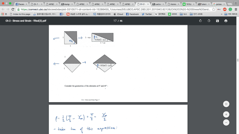

Also, I have another question.
I looked up tensor briefly, and I have a question.
Angle Beta is preserved, and I don't know how it should be. Is this a tensor property that preserved for any type of coordinate system?
if so, could you tell me that how I can mathmatically and physically interpret this.

Well, this is how they teach it to get us started. But, when we do differential force balances to obtain the Stress-Equilibrium equations in solid mechanics or the Navier Stokes equations in fluid mechanics, these stresses are taken to change from one side of the differential cube to the other, and these changes become key terms in the final differential force balance equations.
