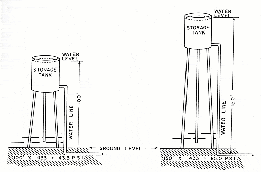

Hello, I was wondering, for a fixed amount of water, why when the height of a water tower increases, the water pressure at the outlet of the pipe at the base of the tower increases ?
I have often read on the internet that it would be caused by the weight of the water above the water at the base of the tower but I doubt this explanation is good.
Example: If we have two identical water towers, with the same amount of water inside, but tower A is 5 meters high, and tower B is 10 meters high, the one that will have the most great water pressure at its base will be that at 10 meters high (tower B) yet the water at their base has the same amount of water above it, so the same weight, so the pressure at the base should be the same for both towers if I followed the explanation I saw on the internet.

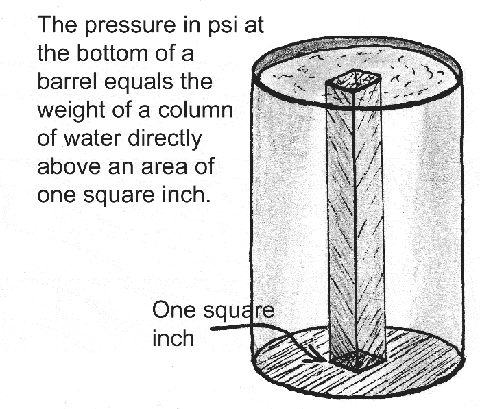

You have to look at the height of the column of water over a given area to find the pressure:

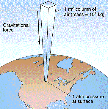

It is also the same thing for air:

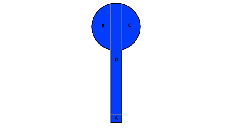

I quickly made a drawing to illustrate my previous message, it will surely be clearer:
If I understand correctly, in a water tower, the water pressure in zone A will only be affected by the water in zone D. The water in zones B and C will not affect the water pressure in zone A.

Sorry but you have got totally the wrong message from a large number of posts above. I wonder if you actually read that link I posted above. It has good descriptions and good diagrams. Hydrostatic pressure is transmitted in all directions. How would household plumbing work if things went the way you describe? Nothing would flow from the tank in the roof to a tap that's not vertically below it

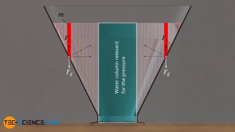

There is even an image that shows the same thing as my drawing but much better:

There is even an image that shows the same thing as my drawing but much better:View attachment 314681
. . . . .except that the green column doesn't have to be there, to produce the same pressure. A single (thin) diagonal pipe would have the same pressure beneath.
The two zones B and C have the same pressures at any height in the tank. You could remove B and the upper part of D and the zone C would still contribute the same amount of pressure to the pressure right at the bottom. That vertical column section is no more relevant than any other; It's just a virtual aid to deriving the equation in anybody of water.
Hydrostatic pressure in any small region of the water acts in all directions - against the side or against the neighbouring volume of water. If that were not true then water would flow and establish equilibrium. Note the word "Equivalent" in green column in the diagram.
