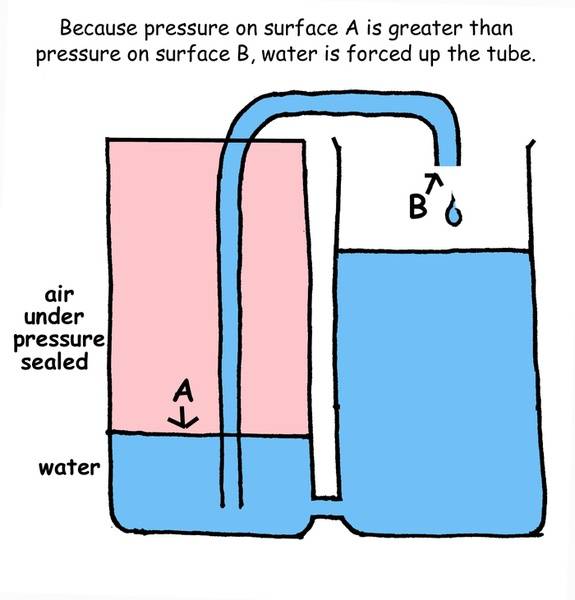

Please look at this drawing of my idea, and tell me if you think it would work.
The compressed air chamber on the left keeps this system un-balanced, and water is continually forced up the tube, and into the right hand chamber.
Sure, it will be forced up the tube -- but also since the pressure on the bottom of the tank on the left is higher than on the bottom of the tank on the right, it will also flow from left to right, filling up the tank on the right directly. So what's the point here: is this an attempt at a perpetual motion machine? FYI, we don't allow that here...
I think that at equilibrium the level in the tube should be the same as the level in the right tank.
Any reason for it to go higher?
OK, I see what you mean...I cave.
