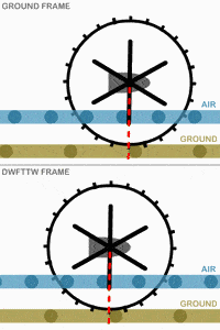

  • #61
chingel said:
But you can't just have the ground turn the propeller without slowing the car down by an equal amount. You can't use the moving ground when driving a car to turn a generator without slowing the car down.
Yes you can:
http://www.youtube.com/watch?v=LMgDvC5lqsY&feature=related
  • #62
mender said:
Because the energy to power the cart is from the wind. After the cart passes, the kinetic energy of the wind is lower; the prop slows down the speed of the air mass (wind) relative to the ground.
If there wasn't a wind, you'd be right. The wind is the external energy source; no wind = no energy source to power the cart.
Yes the propeller slows down the wind, but it takes energy to change the particles speed and the propeller has to do work.
I have seen the videos that it is possible, but I fail to understand it. I was saying you can't do that to the explanation that it somehow just extracts the energy from the moving ground, you can't just extract energy like that, it would slow you down unless something else is compensating for it.

  • #64
A.T. said:
In the cart's frame:
power_ground_to_cart = ground_speed x wheel_drag
power_cart_to_air = air_speed x thrust
chingel said:
This means that the propeller takes as many joules from the cart's kinetic energy
Nope. Read again:
A.T. said:
In the cart's frame the cart doesn't have any KE. But the ground has plenty of it and gives it to the air, via wheels and propeller.
In the ground frame the propeller is taking KE from the air, so it is an energy input to the cart.
Yes I can. Read again:
A.T. said:
You will not slow down, if you use the extracted energy to push against something that moves slower relative to you than the ground. The net force determines if you slow down, not just the force from the ground.
This one is not slowing down either, despite the fact that the reels are braking, in order to turn the blue gear:
https://www.youtube.com/watch?v=k-trDF8Yldc
Now replace the blue gear with propeller and the ruler with the airmass.
chingel said:
The diagrams I don't understand either. They already have 1,5 windspeed at the beginning? What happens at windspeed?
Draw it at windspeed yourself, for exercise. The apparent wind will be horizontal. It is even easier to produce a forward unconstrained force then, with the blade at less pitch.
chingel said:
I can't see how it can bypass taking energy from the cart to propel the air particles. They are standing still to the propeller and to move them it needs energy from the cart, no matter what gearing you use to make it slower or faster.
Nope. Read again:
A.T. said:
Your statements about energy are meaningless without specifying which reference frame you mean.

The key part here (and what differentiates what the cart is doing from "multiplying the force and applying it back to the road") is that the air and the ground are going different speeds relative to the cart. As a result, you can indeed use a gear ratio to get a net force out.
chingel said:
I am having trouble. The wind created will be horizontal, but since at windspeed air is still to the cart and once the propeller is spinning it is moving faster than the air particles and therefore accelerating air particles instead of the other way around.
From the cart's frame of reference, yes. To analyze it further in this frame, the ground is moving at some speed relative to the cart. This turns the wheels, which are connected to the propeller. Clearly, this requires some force at the wheels, so this will cause a power drain on the cart equal to the force times the groundspeed. Depending on the efficiency of the propeller, some of the power is then put into the air. However, the air around the cart is still, and the air through the propeller is moving slowly compared to the groundspeed. Since power is force times velocity, the force from the propeller can be very large (since the velocity of air relative to the prop is small). Even if the power is smaller, the force is larger, and thus, the cart accelerates.
chingel said:
How is the air doing work on the propeller when it is at windspeed? From the ground's frame, they are moving at the same speed and then the propeller uses energy to change the speed of the air particles. The propeller doesn't know what it is doing, the air particles are sitting still in its way and it has to push them away, which takes energy.
From the ground frame, the air is traveling at some velocity, and thus has kinetic energy. After the cart passes, the air is moving slower relative to the ground, thus, the energy that was in the wind was transferred to the cart. The mechanism is somewhat irrelevant - all that really matters is that the wind was slowed by the cart's passing, thus by simple conservation of energy, the wind did work on the cart.
  • #68
chingel said:
OK in the cart's frame the propeller isn't taking energy from the cart, but rather it is trying to accelerate the cart to match the speed of the ground...
The propeller accelerates the cart to match the airspeed of the cart with the propeller pitch.
chingel said:
I am saying that you cannot just use gears on a car to multiply a force and then apply it back to the road.
The DDWFTTW cart doesn't apply it back to the road. It applies the greater force to the air, which moves slower than the ground in the carts frame.
chingel said:
So that the net thrusting force of the cart cannot simply come from the fact that the force from the wheels is multiplied and is greater at the propeller.
It comes exactly from that fact. Your "So" doesn't make sense, because you described a different mechanism before that sentence.
chingel said:
...once the propeller is spinning it is moving faster than the air particles and therefore accelerating air particles...
No, in the ground frame it is always slowing down the air particles. Your "therefore" doesn't make sense, because your conclusion doesn't follow from the premise. The propeller blade can have a higher speed than the air, and still slow down the air. See red tracer in the ground frame clip:
https://www.youtube.com/watch?v=FqJOVHHf6mQ
Draw the vector diagram for the blade when the cart_speed = true_wind. Check the dot product of blade_force and blade_velocity.
If you keep confusing yourself by jumping between reference frames, you will never get it.

  • #71
What I meant is that since the cart is moving faster than the wind, which can be seen from the countless videos, there must be a net thrusting force coming from somewhere. What I am trying to say is that just multiplying the force from the wheels shouldn't matter and I am trying to get an explanation why it does.
Imagine you are freewheeling on a regular car, except it has no air resistance and can convert motion to electricity or do pretty much anything else at 100% efficiency. There is a machine on board that produces photons and it has a flywheel connected to the wheels. The device can shoot out photons with more energy at a lower rate, increasing the thrusting force per photon, or shoot them out at any other combination. Do you agree that in such a scenario the best that is achievable at 100% efficiency is that the cart will maintain it's speed?
In the case of the wind cart, the fact that the force is multiplied somehow causes a net thrusting force on the cart, despite the fact that the power at both ends is the same. Let's make the car shoot out photons with more force but at a lower rate, increasing the force. Does the hypothetical car start accelerating? Then why does the wind cart accelerate when you multiply force, after all, the energy lost by drag and the energy used for propulsion are equal in both scenarios?
Does the reference frame matter regarding the power at the input and output?
A.T. said:
In the ground frame the equation does apply as you suggest:
power_air_to_cart = true_wind_speed x thrust
They should be still equal as far as I understood. If you just think about it, any energy used by the propeller to propel the air particles has to come from the wheels, because that is what moves the propeller.
Another question I have regarding the diagram. Shouldn't the path of the blade be at a right angle to the wind and vehicle speed when it is moving directly downwind? Or is the propeller supposed to not point directly upwind?
When the cart is at windspeed, you are right the wind will be horizontal and the wind will cause the blade to move forward, but, since in the cart's frame, the air is motionless around the cart and the propeller is moving around, the propeller is accelerating the air particles, not the other way around. Every action has an equal and opposite reaction, the propeller is at an angle and throws the particles in one direction and therefore the cart in the other. It takes energy to do that and the energy comes from the wheels. Any energy given to the air particles trying to propel itself is exactly the same energy that is taken from the cart, as the equations show, the joules per second at both ends are equivalent.
No, the wheels just turn the propeller. But the total motion of the propeller in the ground frame is not a pure rotation.
No, not in the ground frame.
The propeller axis is parallel to the true wind. The blades are not moving parallel to the true wind in the ground frame.
No. Read it again and repeat aloud:
In the cart's frame the cart doesn't have any kinetic energy
The net thrusting force is due to a combination of the tail wind and the propeller. If the wind speed is +10 mph, and the cart is moving at +15 mph, then the relative speed of the wind is -5 mph with respect to the cart, while the relative speed of the ground is -15 mph with respect to the cart. The ground speed is 3 times that of the air speed. The cart is designed to take advantage of this difference in speed, since the wheels interact with the faster moving ground and the propeller interacts with the slower moving air. If the effective gearing of the propeller is 1/2 of the ground speed, it would be accelerating the wind from -5 mph to -7.5 mph (1/2 of the -15 mph of the ground speed). Since the speed is cut in half at the propeller, the force could be doubled and power output would be the same as power input (if there were no losses). Since there are losses, either the force and/or speed of the thrust from the propeller will be a bit less, but if the cart is efficient, the speed can be enough to generate more thrust than the opposing force from the wheels, and in the case of BB, where the propeller's pitch (no load thrust speed) is set to 80% of the ground speed, equality between losses and the opposing forces occur at about 3.5x wind speed.
Since power = force x speed, and since the reference frame affects the speed, the reference frame affects the magnitude of the power, but it doesn't affect the calculated forces (or the net force).

A.T. said:
To translate this to the propeller you have to consider the point where the streamline intersects with the propeller blade. This point is also moving slower than the wind, if the cart moves at wind speed:
Could you explain it more a little bit? Where is the point, what streamline, where do they intersect?
  • #80
In the http://www.youtube.com/watch?v=FqJOVHHf6mQ" the stream line is the horizontal column of air (blue with dots). The location where it meets the blade is moving slower than the air (in the ground frame), so the air is pushing forward on the blade. This corresponds to the top of the blue gear that moves slower than the ruler.

Why is the blade moving up? How long can it keep going like that? Is there a similar point when the blade is rotating instead of moving up?
  • #82
For the airfoil the vertical axis in the diagram is the circumferential direction of the helix that the airfoil actually moves along. This is shown right at the begin.
  • #83
When I look at a helix from the side shouldn't I see it going up, then down, then up again etc? But then again it shouldn't matter in which direction the blade is going, it is always at a right angle to the wind in the cart's frame of reference?
In that sense the cart could go faster than the wind, but it is still very confusing, because there has to be an explanation for the energy questions I had. The generator uses power to hurl air molecules, the cart gains kinetic energy, but the generator is getting power from the cart's kinetic energy in the first place (in the cart's frame the energy will cause the ground and cart to match their speed, it doesn't matter, the amount of energy is the same and the effect is basically the same, the energy makes the cart slow down relative to the ground in either frame).

chingel said:
When I look at a helix from the side...
The diagram in not from the side. For the airfoil the vertical axis in the diagram is the circumferential direction.
Yes, but in the ground frame is moving at some other angle, depending on the radial position and transmission ratio. In the diagram it is 45°.
Only at when the cart is at wind speed, and that ignores induced flow. In reality, at some speed below wind speed, induced flow will be zero relative to the ground and that is the only case when blade is moving at "right angle" to apparent wind. At faster than wind speed, the blade moves forward as well as at a right angle relative to the air.
