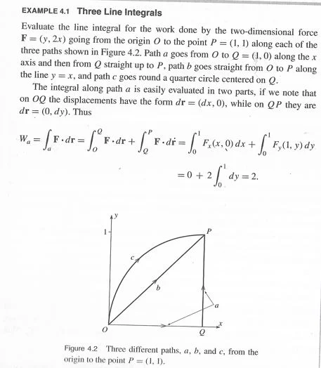

Taylor, example 4.1
I wonder what the work actually represents in this example. Normally, I would say that ##W=\int{\vec{F} \cdot d \vec{r}}## is the work done by the force F as it moves a particle along a path, where the path is determined by this very force. In this case, however, the force points in a direction that has nothing to do with the path of the particle. The particle obviously moves under the influence of some other force that constrains it to stay on its path. The force F does not push the particle along its path, it rather tries to push the particle away from its path. In doing so, it reduces the particle's kinetic energy, and by the work-KE-theorem this means that the force is doing work on the particle. But there is something strange about this work.
There is nothing strange about this. For example, gravity also tries to pull a simple pendulum off its circular path, but that doesn't mean we can't calculate its work.
Yes. Once again I posted a question without thinking it through. Everything is clear, sorry for the bother.

My question was actually due to a very stupid misconception. I first learned about work in 8th grade, where work was defined as force times distance and it was usually done by a guy pushing a cart or lifting a crate. The displacement was always in the direction of the force and it was always caused by this one and only force. And although I have since done calculations with work as a dot product, I apparently never thought it through what this actually meant. I still had this old 8th grade picture of work sitting in the back of my head, and when I looked at Taylor’s example, this old picture came up and acted as a conceptual barrier. That spell is now finally broken, I hope.

Yes. I actually ran into my conceptual problem with Taylor's example, because I always blindly applied the definition of work as a dot product, without really thinking about what it concretely means. I know too many definitions that I have never thought through. I think the main reason why physics has to be learned through problem solving is exactly this: knowing definitions is by far not enough. It is only by applying the definitions that you begin to understand what they really mean.
Applying a force "away from the path" as in "perpendicular to the path" is not doing any work. That is for example what the constraint force does, that constrains the object to stay on a path, no matter what other forces act on it. It's neither acting to reduce nor to increase the particle's kinetic energy.
Applying a force along the path but opposite to velocity is doing negative work (and reducing kinetic energy if no other forces do sufficient positive work to compensate the negative work done). But I don't see for which of the three paths (a, b, c) the force F would do negative work and act to reduce kinetic energy here.
Neither do I. I completely misinterpreted the whole situation.

As a general note: You should not confuse "net work done" (which equals the change in energy) with "work done by an individual force" (which is its path integral). When only one force is doing work (like in this scenario), there is no difference, but scenarios are not always that simple.
