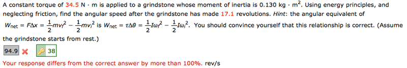

What is given:
Torque: τ = 34.5 N * m
Inertia: I = 0.130 kg * m2
Angular speed: ω = ?
Work done by a constant Torque: τΔθ = (1/2)Iωf2 [STRIKE]- (1/2)Iωi2[/STRIKE]
Angular displacement: Δθ = 17.1 rev/s = 107.442 rad/sτΔθ = (1/2)Iωf2
(34.5)(107.442) = (0.5)(0.130)ωf2
3706.765 = 0.065ωf2
57027.156 = ωf2
238.8 = ω
It's still wrong :(
Δθ is 17.1 revolutions. You need to convert that to radians.
Make sure your angular displacement is in radians, not revolutions.
Change 17.1rev's to ... radians's.
3x should be enough :biggrin:

B]What is given:[/B]
Conversion (17.1 x 2 x π) rad/s = 107.442
τΔθ = (1/2)Iωf2
3706.765 = 0.065ωf2
57027.156 = ωf2
238.8 = ω

Looks like they want the speed in rev/s, not rads/sec.
Sooo...I don't convert angular displacement?
Convert your answer for ω from rad/s to rev/s.
τΔθ = (1/2)Iωf2
3706.765 = 0.065ωf2
57027.156 = ωf2
238.8 rad/s = ω
238.8/2π rev/s = ω
38 rev/s = ω
