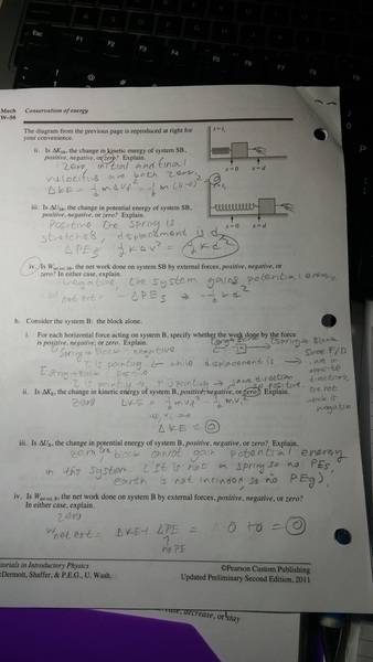

Joe Armas
In the pictures.
KE = 1/2mv^2.
PE = 1/2kx^2
Work external = Delta KE + Delta PE
W = F* d
In the pictures.Comments:
On Problem 3 ai, I am not sure whether I have identified the correct horizontal forces. The hint gave two, but I believe there could also be a force that the wall exerts on the spring.
I am also not sure which way the force points when a spring is stretched and extended. I believe it is in the direction of the equilibrium unextended position. Please let me know if my answers/reasoning is correct. Thank you.
They want you to identify the forces acting on the SB system from outside that system. Is the force between spring and block such a force?
Bear in mind that forces always occur in pairs: an action and an equal and opposite reaction. You can't exert a force on anything if it doesn't push back.
I see, so the force on the spring by the block is equal and opposite to the force by the block on the spring?. So is what I have for 3 a i correct?
No, correct? The only force that I can see is the wall.
That's right, the external forces are from string and wall.
The wall does zero work while the String does positive work right? Since displacement and force is in the same direction?
Yes.
haruspex said:
Yes.
Ok thanks for the help. Do you see any discrepancies on the back side?
Have another think about a iv. This is the work done by external forces on SB.
It should be positive right? The string does positive work while work does negative work. But why is the work net external not equal to delta potential energy here?
What situations can we use conservation of energy for net external work?
No, I'm suggesting you need to distinguish between work done on a system and and work done by a system. They have opposite signs.
The system gains potential energy because the spring is stretched. Isn't Wnet external equal to - delta PE? So it would be indeed be negative? That was my reasoning and it makes sense.
system gains PE because spring is stretched (spring PE is always positive, like KE is always positive).
but no, Wnet,external (positive) is where that Energy comes from that is stored in the spring as PE (positive).
Work done on the system equals gain of work by the system. Both positive in this case.
