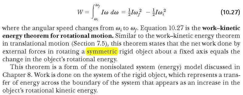

Why it need to be symetric
From the book Physics - Serway
Thanks
Edit:
I'm bringing just the statement from Serway's Physics 9th p 313
That image was a bit too much. It's oversized for one thing, and for another that's verging on copyright violation.
Try again, with words rather than an image. Give a reference to the book (name, author, page number) and summarize the parts you don't understand. You can quote a paragraph or two, but an entire photocopied page is just too much.
I reopened the thread. Please try to summarize your concerns in words, not with a scanned image, and we'll do our best to try to answer your questions.
The next time you post a scanned image, please try to resize your images so they're a bit smaller than this -- 640 by 480 or so.
The reason it has to be symmetric in that freshman level physics text is that freshman do not yet have the mathematical skills to cover the full problem. The problem is that ultimately moment of inertia is not a scalar. It is instead a second order tensor. You haven't studied tensors. You might *start* studying them in a couple of years. There is nothing in that more advanced treatment that necessitates that an object be symmetric.
By making the object in question symmetric, moment of inertia can essentially be treated as if it was a scalar, just like mass. This simplifies the problem of rotational motion to something that is understandable at a freshman physics level.
cool. making sense
(I would expect from the author to be more clear about that)
