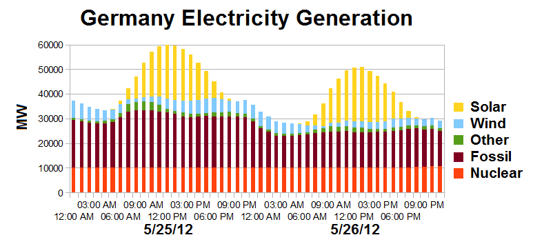

Germany is one of the leading countries in using solar power. Below is a chart of the electricity generation during two days.
Source

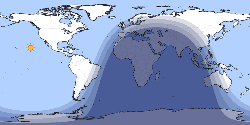

At 9 pm the solar production stops. If you would still use solar power in Germany at this instant of time you would have to import it from a location with sun. Below is such a map. At 9 pm on the day in question:
Source
As noticed, your options are limited due to the Atlantic ocean (unless you can have offshore solar plants?) During the morning, your options will be better, allowing import from the eastern countries.
