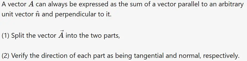

A vector ##\vec A## can always be expressed as the sum of a vector parallel to an arbitrary unit vector ##\hat n## and perpendicular to it.
(1) Split the vector ##\vec A## into the two parts,
(2) Verify the direction of each part as being tangential and normal, respectively.

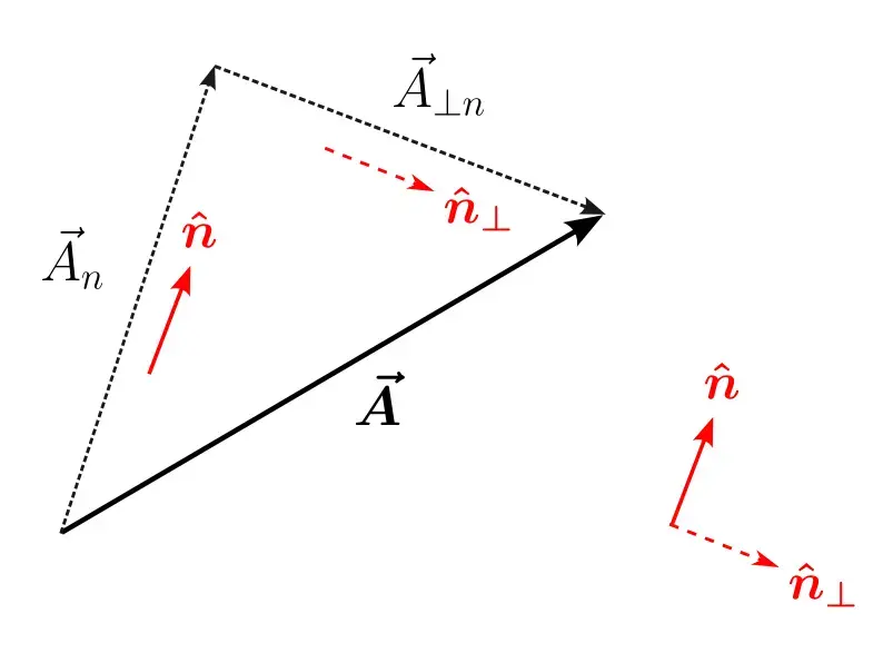

Let me begin by drawing an image of the problem which I show to the right. During the drawing, it made sense that this separation is possible and unique.
Shown in the image alongside, we are given a vector ##\boldsymbol{\vec A}## and a unit vector ##{\color{red}{\boldsymbol{\hat n}}}##. Effectively then, we are also given the unit vector perpendicular to it ##{\color{red}{\boldsymbol{\hat n}_{\perp}}}##. The vector ##\boldsymbol{\vec A}## is decomposed into two parts, along and perpendicular to the given vector :
\begin{equation}
\boldsymbol{\vec A} = \vec{A}_n+\vec{A}_{\perp n}
\end{equation}
Question : What are the vectors ##\vec{A}_n\;,\;\vec{A}_{\perp n}=?## in equation ##(1)## above?
Attempt : I could guess (see Relevant Equations above) that the vector parallel to ##{\color{red}{\boldsymbol{\hat n}}}## is ##\vec A_n=(\vec A\cdot \hat n)\hat n.{\Large\checkmark}## This matches with the answer given.
I have no clue as to how to go about with the other vector ##A_{\perp n}\; \hat{n}_{\perp}##. If I carried out a cross product ##\vec A_{\perp n}=\hat n\times\boldsymbol{\vec A}##, it would go out of the plane. That would not be fine according to my first doubt (see below).
Doubt(s) : I am afraid I have several.
(1) Is this problem valid only for 2 dimensions? (That's what it seems to me. In three dimensions, there is a plane perpendicular to ##{\color{red}{\boldsymbol{\hat n}}}## implying an indefinite number of unit vectors on the plane and perpendicular to the given unit vector, making the decomposition of ##\boldsymbol{\vec A}## non unique.)
(2) Even in two dimensions, have I drawn the perpendicular unit vector ##{\color{red}{\boldsymbol{\hat n}_{\perp}}}## correctly, keeping uniqueness in mind? I show what I mean in the image to the right.
(3) What is ##\vec A_{\perp n}##?
A hint or a clue would be of help.
Same as in your drawing: ##\vec{A}_n## is the component of ##\vec {\bf A}## along ##\hat n## and ##\vec{A}_{\perp n}## is ##\vec {\bf A} - \vec{A}_n##
[edit] Note that ##A_n## is a number and ##\vec A_n=A_n\,\hat n## is a vector
Doubt(s) : (1) Is this problem valid only for 2 dimensions?
The decomposition is valid in any number of dimensions.
(I.e. the relevant equation works fine in any number of dimensions. Your "Effectively then, we are also given the unit vector perpendicular to it" is only correct in 2 dimensions -- [edit] except, as you noticed, there is a choice)

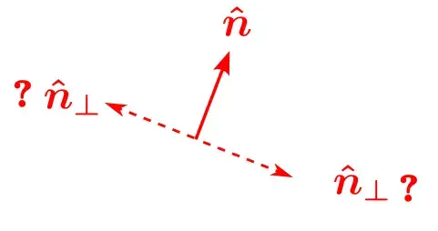

correctly, keeping uniqueness in mind. I show what I mean in the image to the right.
You are supposed to treat the unit vectors as given.
The decomposition process is unique.

I agree with you. There are two unit vectors as I show here but the decomposition of the perpendicular component can only be along one unit vector (marked ##\hat n_{\perp}##) or another.
So let me see. The vector perpendicular to ##\hat n## is ##\boxed{\vec A_{\perp n} = \mathbf A - (\vec A\cdot \hat n)\;\hat n}## .
I can't reduce the expression on the R.H.S further. However, I can tell you this is not the answer given in the text.
##\boxed{\mathbf A = (\mathbf A\cdot \hat n)\hat n + \hat n \times (\mathbf A\times \hat n)}##

In three dimensions, for instance, there will be an infinity of perpendicular unit vectors n^⊥ along the plane normal to the given unit vector n^. Are you saying that the perpendicular component of A, which I am calling A→⊥n , which will pick one of them only?
Assuming ##\hat n## and ##\vec A## are not collinear, the two vectors define a plane. ##\vec A_{\perp n}## and ##\hat n_\perp## have to lie in this plane.

Homework Statement: A vector ##\vec A## can always be expressed as the sum of a vector parallel to an arbitrary unit vector ##\hat n## and perpendicular to it.
Relevant Equations: Using the dot product, a vector can be projected along a unit vector chosen arbitrarily : ##A_n = \vec A\cdot\hat n.##

The more relevant conputation is showing that the orthogonal component is indeed orthogonal to ##\hat n## and that the parallel component has the same inner product with ##\hat n## as ##\vec A## itself.
Orodruin said:
On the contrary. It is very reassuring that the components of ##\vec A## add up to ##\vec A##. You should worry if they didn’t!
True, if I see 🐻 = :cat: + 🐻 - :cat: , I don't worry whether things add up.
It doesn't say anything interesting either.
Orodruin said:
I actually think ##\vec A - (\vec A \cdot \hat n)\hat n## is nicer than the double cross product. It also generalises to any dimension.
When learning relativity, this decomposition was one of my "a-ha" moments
because I could see the use of the vectors ##\vec A## and (not necessarily unit) ## \vec n ## and the metric.
(see p16-17 of General Relativity (1972) at https://home.uchicago.edu/~geroch/Course Notes )
The cross-product form is secondary and is possibly useful in (3+1)-cases...
but is not helpful in (1+1)-cases.
In addition, this decomposition is used repeatedly in the Gram-Schmidt Process in linear algebra.
The cross-product is generally not useful here.
There is actually a generalization of the cross product to arbitrary dimensions that will do the same trick asthe cross product. However, it maps two vectors anti-symmetrically to an antisymmetric N-2 tensor. The end result can be expressed using the generalized Kronecker delta.
