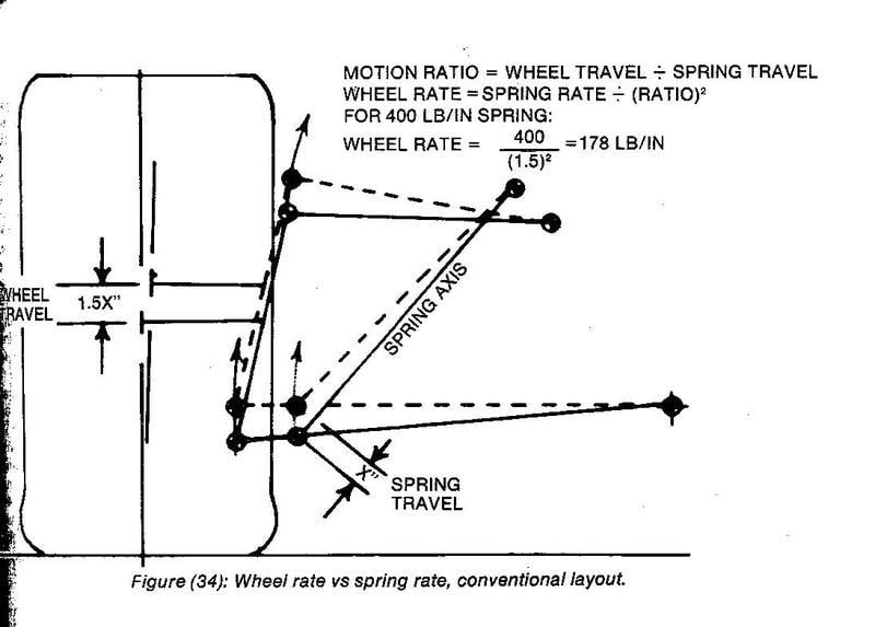

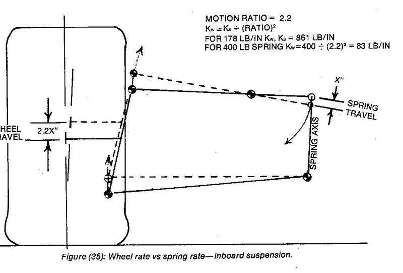

Spring rate vs. Wheel Rate - Springs are rated in terms of resistance load placed on the spring. Usually springs are rated by pounds per inch..i.e. 400 pound spring means if 400 pounds were placed on the spring it would compress one inch.
Wheel Rate (WR) is the effective rate of the spring at the lower ball joint (BJ) located on the lower A-arm or control Arm which compresses the spring (modern independent suspension). WR is Spring Rate (SR) actual effective value after the mechanical advantage or leverage. This factor is Motion Ratio (MR) is the linkage squared. look at Wheel Rate illustration - note MR is the pivot point to center of the spring distance A divided by total effective length of the A-arm B.
Wheel Load Rate - racers were concerned about WR because the BJ is located several inches away from the center of the tire contact patch...if we look at the calculations of the Wheel Load Rate we find the difference is VERY SLIGHT. IMO, the ease of calculating Wheel rate vs. Wheel Load Rate and keeping things simple out weight the additional effort.
Coil Over Wheel Rate- this calculation is similar to the conventional A-Arm set up but we have t add in the cosine squared of the shock mounting angle. Again, all things I racing are compromises and the limited space on the front end where you can mount coil over shocks and not limit engine accessibility for maintenance dictates the mounting angle..More angle decreases the leverage...see the angle / cosine table

before we get int oin board suspension lay out and formula car wheel rate calculations..i need to dig out my notes on "how to calculate the proper springs for a given race car" both ..front and rear...because if you do not know where to start as a base line it will take days at the track to trial and error the set up until it gets close..
Ok, here is how we determine the proper springs for each corner of the race car. you asked about loads on each wheel..well here is an example of our old door slammer running on a medium banked asphalt track.
Stock suspension with solid rear axle.
We calculated that it is under 1.3 Gs in the turn. " F= ( m*v^2 ) / R " is correct formula
one more piece to ponder..
from our cone killing days in SCCA Autocross..skid pad testing ,,go to parking lot, airport,,what ever, set up circle 200 to 300 feet in diameter, drive around the cirle as fast as you can without spinning out..
G = 1.225 x R / T squared
R= Radius of the turn in feet
T = Time in seconds to complete a 360 degree turn
typical Corvette corners at .84gs
road race sedan like Tran Am 1.15 Gs
if you know the tire performance curve from the manufacturer charts weight (vertical load in static pound) vs Traction (lateral load in lbs) you can calculate the Cornering efficiency.
This particular car weighs 2800 lbs. of 35% of weight will transfer under 1.3 G
and 75% will be on front end due to engine weight and corner loading
2800 lbs. X .35% = 980 lbs. transferring or loading tires
75% of 980 lbs. = 720 front end weight
divided by three to determine wheel rate ( two front springs and sway bar )
so we need wheel rate of 240
Wheel rate = (Length of A-arm divided into inside frame mount point to center of spring mounting point) squared
times spring rate
now the hard part
get out the tape measure and measure bottom front A-arm length
1. inside frame mount point to center of outside ball joint
2. distance from inside frame mount point to center of spring mounting point
stock Chevy A-arm is
16.5 inch inside frame mount point to BJ and 9 inch from inside frame mount point to center of spring pocket
assume you have a 800 lbs. spring
wheel rate = 9 / 16.5 = .54
.54 x .54 x 800 = 233 lbs. spring required to handle weight transferred

We can see the effect of wheel rate regarding spring placement. Conventional coil over shock A-arm layout and the Formula Car inboard suspension which has a lot less unsprung weight.
