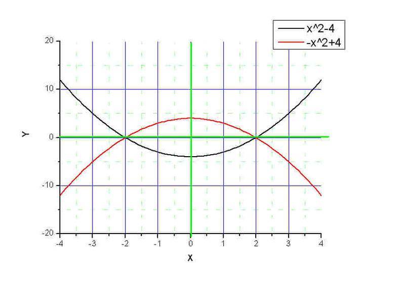

The graph of the quadratic polynomial , y=ax2+bx+c is as shown below in the figure :
http://postimage.org/image/nvkxv74yd/
Then :
(A) b2-4ac<0
(B) c<0
(C) a<0
(D) b<0
y=ax2+bx+c

Many thanks to NascentOxygen , Tom Mattson , ILS and Morgoth for their hints ! :smile:
I think I figured out this problem.
The first option A i.e. b2-4ac<0 is incorrect because that parabola is yielding real roots. Option A is out.
When that parabola is cutting the y-axis then of course x=0
So
this implies that
y=a.02+b.0+c
y=c
As we know from graph that y is positive so c is also positive. This implies that c>0.
But option B says that c<0 which is wrong. Option B is out.
Now when parabola is intersecting on first quadrant (+) of x-axis , then y=0 (we can also take -x axis also.)
so
0=ax2+bx+c
As we know that
m = Δy/Δx
We know from above equation
m = (y-c)/x where c is y intercept. As y = 0 then also c =0 because Δy=0 here. We aren't taking in account y intercept because its 0 !
This implies y=c=0
So we know b2-4ac>0 as its yielding real roots.
so b2-4.a.0>0
b2>0
or1
b>0
But option D says that b<0 which is incorrect as we found that b>0 so option D is out.
Now only option which is left is C which has to be correct because ,
x = {-b+-sqrt(b^2-4ac)}/2a
as c=0
I get 2 values :
x= (-b+b)/2a
x=0
And
x= -2b/2a
x=-b/a
Now here x is positive because axis is +x. To make "x" positive "a" has to be negative as we know before that "b" is positive. This implies that a<0.
QED.
I got the correct answer but am I methodically correct ?
Thanks again !:smile:

Let's inventorize:
1. the parabola intersects the positive y-axis at y=c, meaning c>0
2. the parabola intersects the x-axis at 2 points, meaning b2-4ac >0.
3. the parabola opens up downward, meaning...?
4. at which x-coordinate does the parabola have its maximum? And what to deduce?

You do overcomplicate the problem. Look at NascentOxygen's big formula:
y=ax2+bx+c
and compare with your drawing:
The curve intersects the y-axis at a positive y value.The points on the y-axis correspond to x=0. Therefore
c>0
A general parabola can be obtained from the standard y=X2 one by shifting it along x, y and multiplying by a number a as
[tex]y=a^2+bx+c=a\left((x+\frac{b}{2a})^2+(c/a-\frac{b^2}{4a^2})\right)[/tex]
If a is a negative number, the parabola is upside down with respect to the standard one. The standard one is open upward. Your parabola is open downward, so
a<0
b/2a shows the shift of the parable along the x direction. As I see, your parabola is not shifted.
ehild

Now I am taking your 10th quadratic equation to plot the graph which is attached with the post , a bit too untidy:
f(x)=(x+1)(x-3)
f(x) = x2-2x-3
Let f(x) = y ,
y=x2-2x-3
Wow ! I see that in my graph concavity is in upward direction and so a>0 , b<0 and c<0 !

I send you a bunch of parabolas to get familiar with them. Notice that they are symmetric, the axis of symmetry is parallel to the y-axis and goes through the peak, and the peak is halfway between the roots. Notice that the concavity depends on the sign of the multiplier of x2 alone.
Which parabola is most similar to the one in your original post?
ehild
ehild
I guess that the parabola in somewhat light blue colour is the approximate match of my parabola in post 1 : https://www.physicsforums.com/attachment.php?attachmentid=42155&d=1324617111
Your parabola in post #1 is not a real parabola but it has maximum at x=0. So it must be symmetric to the y axis. It would be useful to see the original picture or a better copy of the original.
If the maximum is really at x=0, what is b then?
ehild
