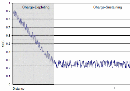

This means that 78% of the people who drive the Volt will use little to no gasoline.
The remaining 22% will have to burn some fuel. KM has done the math for those people.
http://media.gm.com/servlet/GatewayServlet?target=http://image.emerald.gm.com/gmnews/viewpressreldetail.do?domain=12&docid=56132"
Under the new methodology being developed, EPA weights plug-in electric vehicles as traveling more city miles than highway miles on only electricity. The EPA methodology uses kilowatt hours per 100 miles traveled to define the electrical efficiency of plug-ins. Applying EPA's methodology, GM expects the Volt to consume as little as 25 kilowatt hours per 100 miles in city driving. At the U.S. average cost of electricity (approximately 11 cents per kWh), a typical Volt driver would pay about $2.75 for electricity to travel 100 miles, or less than 3 cents per mile.

To be clear, the electric motor is the only motor mechanically connected to the wheels in a serial hybrid plugin like the Volt and that motor is rated 150HP - adequate for hill climbing when it is supplied with rated current. One mode of operating the vehicle then is for the first 40 miles the 70HP ICE is simply off, and the electric motor runs only from the battery. When the battery reaches 30% state of charge, then the ICE kicks on and starts generating power for the battery. If the tractive load on the electric motor is, say, ~70HP (neglecting losses) from a slight grade or acceleration demand, then the vehicle meets the demand of the driver and the battery is not further depleted with the ICE running at full power.
If the vehicle is climbing a major hill as you described, then let us say the electric motor has to draw ~150HP to climb it, and it will deplete the battery at rate of 80HP down below 30% of full charge for the time to climb the hill. The vehicle controller has some programmed limit as to how long it will allow that to happen before it says no more and forces the power supplied to the motor back to down to 70HP. It will not allow the battery to ever reach full discharge, or anywhere close to that.
Figure 7 from the Kromer et al reference above attached to illustrate the two modes in PHEVs like the Volt - charge depletion (1st 40 miles), and charge sustaining.
