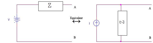

Does it matter if the resistor is on top or below a voltage source after doing a source transformation?
According to this picture from wikipiedia, the resistor is on top of the voltage source:
But even if the resistor (Z) was on the other side of the voltage source, it would still be equivalent to the current source parallel to Z, right? Because the current-voltage characteristic is still the same?
Totally the same. Most designers use the lower line as the lowest voltage -V or gnd; as such the resistor is shown on the high side the the voltage source, but the results between A & B are just the same as you determined.
Your choice of description ("on top or below") seems to me to be not only non-standard but inaccurate. you are talking about a series circuit and its equivalent parallel circuit. Rather than saying the resistor in the first diagram is "on top", it is better described as "in series with".
"on top (above?) or below voltage source" refers to before the transformation. After the transformation it is alongside a current source.
do you mean: "if i started with the resistor drawn below instead of above the voltage source, that is between V- and B instead of between V+ and A, would the result of my transformation be the same, as shown on the right of my drawing?
Totally the same
incorrect
in the left diag, the resistor is in series with the load across A and B
in the right diag, the resistor is in parallel with the load across A and B

The two circuits are legitimate equivalents so I'm not sure that distinction matters. The load sees identical circuits. The second is the Norton equivalent of the first (or, if you prefer, the first is the Thevenin equivalent of the second)
I took the OP at the position that he understood the series Thevenin and parallel Norton equal. I understood the question to be "Does the series component ordering of the resistor and voltage source matter in the Thevenin circuit?" The answer to that question is NO. I took him to understand that the parallel Norton circuit was as stated and he just wanted clarification on the ordering. Hopefully if the OP was asking a different question, he will restate it more clearly.

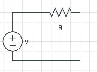

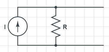

Here is what I originally meant in my question.
I know from Wikipedia that these two circuits are equivalent:
1.
2.
However, I am unsure if these two circuits are equivalent:
1.
2.
yes, as far as the outside world (the load) is concerned, they are equivalent, but that does assume you take your ground point as being to the right of the resistor in the series circuit.
This is more clear if you simply draw the resistor vertically above or below the voltage source.
