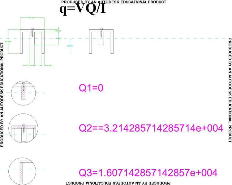

in a question i am asked to calculate the shearing force in a nail holding a cross section together, the cross section is showed in my diagram.
my problem was that after calcultions i found that the centroid of the entire cross section was the same as the centroid of the secondary piece(the block) being nailed to the channel cross section, meaning when i calculate the shear flow (looking only at the block) i get zero, because Q=0,(Q=y*A and y=0), q=VQ/I=0
i checked this by calculating the shear flow in 2 other ways and comparing and i really found that the shear flow at the point of the nail is zero, can this be?? is this a trick question?

I had to blow up the picture to see it more clearly. It appears that you have a (wood) channel shaped section nailed to a (wood) rectangular shaped section. To calculate the shear flow, q, in units of force/length, at the nail, you need to find the Q of the total areas below the horizontal axis where the 2 sections meet (or the Q above that point, which yields the same result). You can't just use the Q of the rectangular piece,which is 0 (if you did the numbers correctly, I didn't check them). Problem is, once you determine the correct Q, which is non-zero, then you need to know V, the vertical shear, which is not given. Then you need to know the nail spacing to determine the shear force in the nails, which is also not given. As I see it.
Jay, are you sure about that?? V, and the spacing c are not that important to me let them remain parameters.
once i find the Q for the entire lower section (it will be 2*1.6=3.2 since q of the block is 0) how do i find the shear flow just through the nail- the Q=3.2 is the Q of the nail and the Q of the 2 legs and you said that i cannot calculate the Q of one part alone.
At some point I'll check your numbers, I can't read them very well on the picture. But I don't believe you are calculating Q (the first moment of area of the cross section) correctly. You want to calculate Q about the axis where the 2 sections are joined by the nail (that is extremely important, as Q changes depending on what axis you use). It is easier to calculate Q above that axis, because you just have one area to deal with, the 100 x10 (= 1000) rectangle. Then Q = 1000(y'), where y' is the distance from the centroid of that 100 X 10 rectangle to the centroid (neutral axis) of the entire section. (You can calculate Q using the area below the nailed axis, and get the same result). I is the moment of inertia of the entire cross section about the neutral axis.. Then, to calculate shear flow, q, at the nailed axis, q=VQ/I (units are force/length), and the nail force is q(c), where c is the nail spacing along the beam.
so (y') would be the distance between the neutral axis (yc=440/7=62.857142857142861) and the centroid of the top shape (y=95)
(y')= 95 - 440/7 = 225/7 = 32.142857142857146
Q=100*10*225/7= 225000/7 = 3.214285714285714e+004
which is what i had before, can you check this.

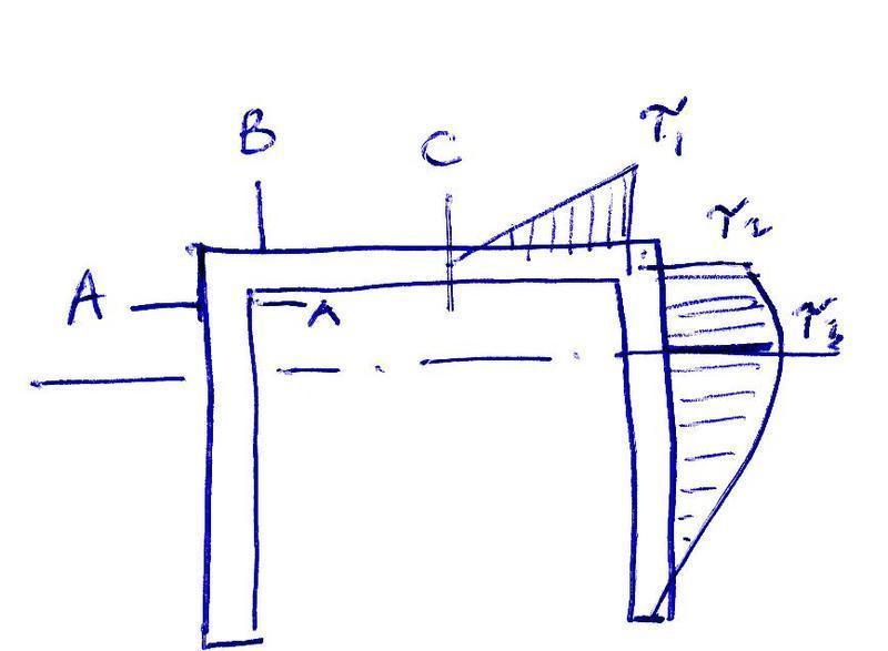

If you take a section just below the flange/webs interface, then Q is not the first moment of area 'above' that section (unless you want the combined shear flow in all three webs), but the first moment 'beyond' that section. So, on the attached sketch, if you wanted the shear stress at section AA, tau 2, you would take Q as 90*10*(90/2-440/7). If you want the shear stress at section B, tau 1, Q = 100*10*(100/2-440/7). This would be almost the same. If you want the shear stress at section C-C, you would get zero because Q just the left of CC is 50*10*(95-440/7) + 90*10*(90/2-440/7) which is zero, when paying attention to signs above and below the centroidal axis. You will notice my sketch does not include the 20 thick extra bit. Assuming its centroid coincides with that of the channel section, there will be a zero shear stress at the nail. Thanks to Jay for helping. I find this a difficult area too. Curiously it seems then that the 20 dimension is not relevant, as the centroids would always coincide.

Thanks, I stand corrected. No force in the nail implies that the nail is not needed, and that therefore there must be no slippage between the 2 sections under bending loads, even without the nail. I guess that's because the centroids line up.
