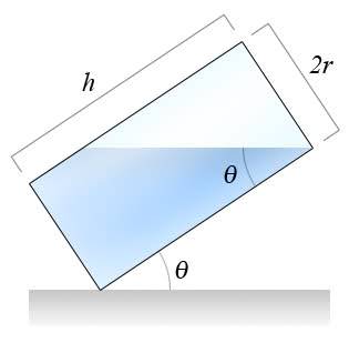

I think this one of the answers, but someone will have to check this. I assumed that you can treat the glass as a simple box.
http://img23.imageshack.us/img23/2062/glassp.png
If the glass is more than half full, then the surface will sort of rotate around the centre of the glass. From the right angled triangle that means θ=arctan(r/(h-x)).
Ignore the second diagram because i just realized it doesn't work for a circular glass.
I suppose x in your diagram is the initial height of the liquid when not tilted?
Are you sure this height remains the same (in the center) when you tilt the glass? That simplifies things alot, but I'm not so sure if that is valid...

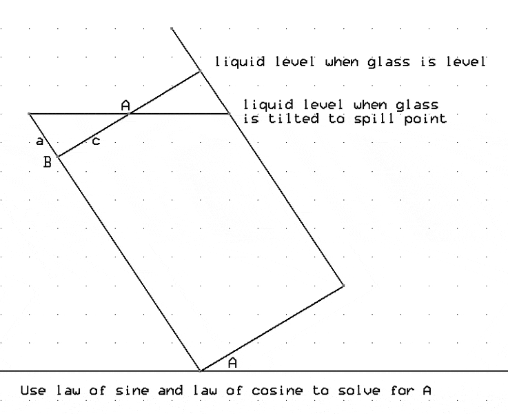

[tex]A = \arccos \left(\frac{c \left( \sin B \right)}{\sqrt{a^2 + c^2 - 2ac \left(\cos B \right)\right)}}[/tex]
where:
A = the angle of the glass when the water reaches the spill point
B = the angle of the container wall on the spill side (when the glass is level)
c = the radius of the container at the water level in the direction of tilt (when glass is level)
a = the distance from water level to the top of the wall of the container on the spill side (when the glass is level).
I used the law of sines and the law of cosines to arrive at this. But anyone please verify that it is correct.
Edit:
I think this solution only works if the water level does not reach the bottom of the container when tilted to the spill point.

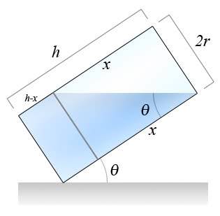

I can now confirm that cosmo's answer is correct, here is why:
Since the volume of water should be the same before and after tilting, we can simply calculate it in both conditions, and derive an expression for the angle from that.
Symbols used as in the picture. The initial water height when not tilted is H (not shown in image).
The volume when not tilted is of course just:
[tex]V = \pi r^2 H[/tex]
When tilted at an angle, we can basically form two regions, one rectangle and one triangle (actually: cylinders). The 'rectangle's volume is just [itex]\pi r^2 (h-x)[/itex], while the 'triangle's volume is just half the volume of a cylinder: [itex]\frac{1}{2} \pi r^2 x[/itex]
Of course, this must be equal to the volume when not tilted, so we have:
[tex]V = \pi r^2 H = \pi r^2 (h-x) + \frac{1}{2} \pi r^2 x[/tex]
[tex]H = h - x/2[/tex]
Finally we know that x is equal to:
[tex]x = \frac{2r}{\tan \theta}[/tex]
So:
[tex]H = h - \frac{r}{\tan \theta}[/tex]
Or, solving for the angle:
[tex]\tan \theta = \frac{r}{h-H}[/tex]Still, this method too breaks down when the initial height H is below a certain level (h/2??), because the volume calculation is then no longer correct (since you cannot form the 'rectangular' part anymore).
