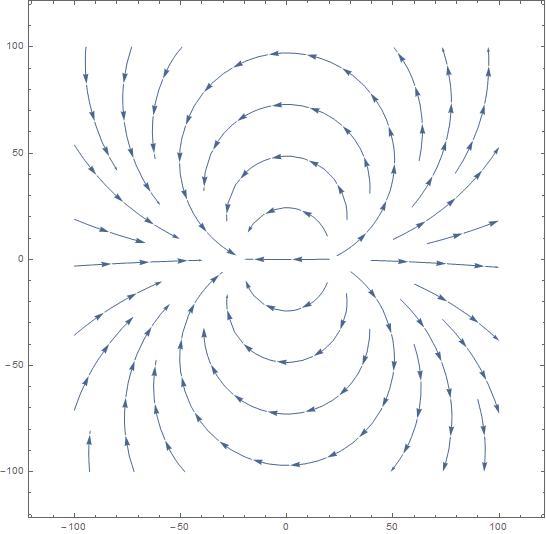

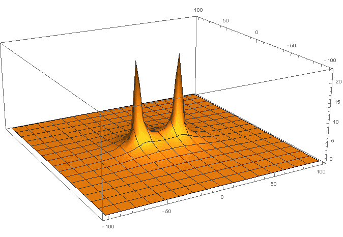

##a## is just an arbitrary constant that defines the positions of electrodes on my plate. The electrodes are at ##(\pm a,0)##.
Plotted vector ##\vec j## looks like this:
Plotted ##|\vec j |## looks like this:
So, current density is defined on whole 2D infinite plate, but is the biggest on the area x2 + y2 < a2 as you mentioned, yes.
Looks pretty to me... Also looks familiar ! (also you have me wondering what program is so smart it draws these magnificent curved vectors, but dumb enough to give them all the same size...)
