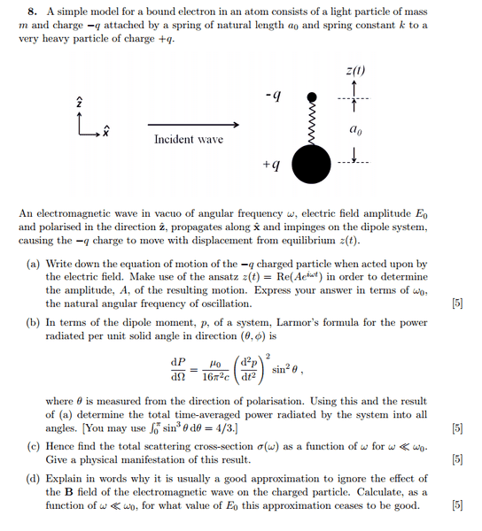

A z-polarized incident EM waves hits a small charge (-q) bounded to a massive charge (+q) with spring constant k0 and frequency ω.
(a) Write down the equation of motion
(b)Find time averaged total power dissipated.
(c) Find classical scattering cross section σ (thomson)
(d) Find value of E0 that makes magnetic forces non-negligible.
