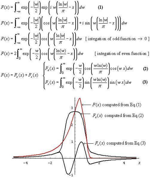

Probably, there is a misunderstanding.
The integral eq.(1) is the sum of two regular functions Eq.(2) and (3).
I cannot see any singularity.

Hi! JJ,
Cos(a+b) = cos(a) cos(b) - sin(a) sin(b)
so actually what you want to plot is (2) minus (3), not plus...
which is such that the function abruply goes to zero (and stays exactly there) at -pi^2/6
It is a singularity in the same way that the function f=(0,x<=0;exp(-1/x),x>0) has
a singularity at 0: all derivatives vanish... but only exactly on the real axis. On the
complex plane the series diverges/oscillated like crazy (no Taylor expansion possible...).
a = w*ln(w)/pi
b = -w*x ... (not +w*x)
Cos(a+b) = cos(w*ln(w)/pi) cos(w*x) + sin(w*ln(w)/pi) sin(w*x)
The sum is (2) plus (3), not minus.
And, as a matter of fact, the red curve ploted in not { (2) plus (3) }, but it is (1), before any transformation.
Also I ploted first { (2) plus (3) } but the curve is not visible because it is exactly the same as the curve (1).
I have doubts about that. It seems that, when x is positive and large, both fonctions Fc(x) and Fs(x) tend to zero, Fc(x) with positive values and Fs(x) with negative values, both tending to a common absolute value : i.e. Fc(x) equivalent to -Fs(x) . Equivalent, is not equal : the sum isn't exacty 0, but very close to 0.
So, Fc(x)+Fs(x) tend to zero very quickly, as it is often the case, due to exponentials.
The computation of the sum of two very low numerical values of oposite sign is hasardous.
I would not swear to it, but I think that the appearance of a threshold is related to the precision of the numerical integrator. If the threshold is crossed, the numerical result is 0, instead of a correct very low but not nil value, which moreover tends even more quickly to 0 when x increases.
I think that pi^2/6 is an empirical result, only due to hasard and without signifiance.

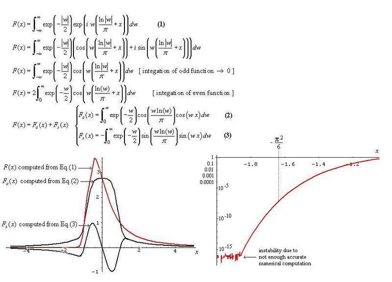

Hi! Lamarche,
The document showing that there is no singularity around x=-pi²/6 is in attachment.
The sign of x has been flipped.

Your data looks convincing. I had the wrong intuition.
Do you think the function actually reaches zero at some negative value (e.g. -2 ?)?
or do you think it is entire? I tried a Taylor expansion on it, and I actually got some hints
of an infinite radius of convergence!
