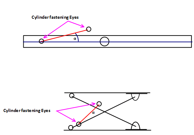

Hi.
I am currently working on a scissor lift design. I'm having some trouble deriving the equations for the actuator force for some reason. Think I'm getting blind on this ATM or something :P. Anyways if someone could help a bit id appreciate it. [I have derived equations I'm just not sure I did it all the right way]
I have all information but the reactions and force in the actuator. Only seeking some standard derivation to se if I did correct or not :) [all other information is available) And actuator is placed between scissor arms.
The scissor lift will start from bottom and up. So the alpha angle is small.
Se picture
