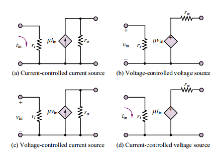

I've been reviewing my electrical theory and I'm having trouble trying to calculate an expression for the voltage gain for these two specific circuits. (Images c and d of the question.png attachment). I already know the answers, however I am unable to derive the same solution. Answers are given with my solution attempt.
Kirchoff's loop law and current junction law.
Voltage gain = Output voltage/Input Voltage
R_s is source resistance, R_L is load resistance.
r_o is amplifier output resistance and r_i is amplifier input resistance.

Part (c): well, the input voltage is Vin and the output voltage is what if the controlled current source is μVin feeding an output impedance of ro?
What function, if any, does ri have?

Now that you've included the entire circuit - yes, it matters. It's a voltage divider as you said.
You're on the right track.
