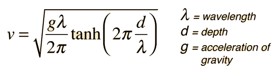

Find Wavelength and Velocity of an Ocean Wave.
Known Variables:
Water Depth=300m
Frequency=8secs
Amplitude=3m
Wavelength (m) X Frequency (s-1) = velocity (m/s)
v=velocity
I have 2 missing variables for both of the above equations.
Am I missing a variable or equation?
Thanks.

If you replace [tex]\lambda [/tex] in your equation according to
[tex]\lambda = \frac{v}{f}[/tex] where f is known
you will have an equation with only one unknown, v.
However this equation cannot be solved analytically but only by numerical methods.
