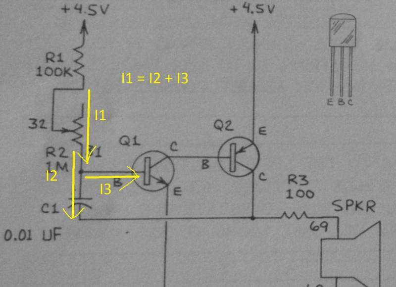

So I want to start off saying that I'm a senior in college in Electrical Engineering and I've been learning a lot about various kinds of circuits involving oscillators and I would like to know more about them. In school we talk a lot about them in various circuits and how important they are to those circuits but we haven't really learned anywhere how a simple oscillator works outside of ideal conditions for an LC circuit.
But since those don't exist in real life you have to be clever and invent a way to make something oscillate. And from my research most of the oscillators today use transistors in various combinations with capacitors and resistors (OpAmps, 555 timer, etc). I have an old radioshack lab book that works you through various electronic "projects" to help you understand circuits and I remembered it had an oscillator example, so I decided to open it up and try it out, and maybe that would help me understand it better. Even after reading the authors note and drawing up a circuit diagram myself, and changing the layout of the circuit so maybe I could understand it better, I'm still confused about how its oscillating.
If someone could explain it to me in detail step by step how its oscillating I would be greatly appreciative as this is something that has been bothering me for some time now. I want to have a fundamental grasp of how a basic oscillator would work. So I figured I would present my question to the awesome guys here at PF who explain things so well. I attached the picture of the circuit with the authors explanation of what's happening.
What bothers me is how the capacitor and the PNP transistor operates in this circuit. The capacitor is constantly being charged, so how could it discharge through Q1? Wouldnt it just discharge while charging? So nothing would happen and that whole part of the circuit would just stay an open circuit after the capacitor has charged fully.
Also the PNP transistor...I must not have a good grasp of how PNP transistors work because I would think the PNP transistor would always be on (current flowing from emitter to collector) and then when current is applied to the base it would turn off. Although I know from my electronics class you don't necessarily have to apply current through collector-emmitter so it does depend on how the configuration is setup. In this circuit they claim that once the NPN "turns on" when the base has current flown through it then current flows through emitter-collector of the PNP. That to me suggests current is flowing from NPN through base-collector through to the base-collector of the PNP. But then wouldn't that mean the NPN is off?
Any help in understanding this would be greatly appreciated. Thanks in advance PF guys!

I don't understand why Q1 ever turns off once it is turned on.
When Q2 turns on there is a huge surge through the base of Q1 as the cap is clamped to 0.7V by the Q1 BE junction. C1 may then try to discharge through Q1 BE, but the current through the resistor (that was enough to turn it on initially), would keep it turned on.
If Q2 ever did turn off there would be a -4.5 volt transition at the base of Q1.
@meBigGuy
From my understanding, right when the circuit is turned on, the capacitor is charging through the current from the sum of the resistances in series with the voltage source. Applying KCL at the node (in the attached diagram) you can see the current divides between the cap and the base of Q1. Right when the circuit is switched on, there is max current at I2 (in my diagram) but it decreases as the cap gets charged, and when the capacitor is fully charged it should become an open circuit and now I3 = I1.
At a certain point in the charge level through the capacitor the current to the base will reach a certain level and turn on Q1 because the current reaches a certain threshold in the transistor and "turns it on". So in theory if the capacitor discharges somehow the current through the base would decrease as the current gets split again through the capacitor and the base of Q1 which would lower the threshold level of the current and "turn it off".
What I don't understand is how that capacitor would discharge once its fully charged, since a voltage source it constantly being applied to it. Is the discharge rate faster than the charge rate of the capacitor or something? (which would be due to the RC circuit set up).
Correct, but you forgot the other half of that story.
When Q2 turns on, there is a +4.5V jump at the base of Q1, (well, actually a bit less than that) because of the voltage across the speaker.
That reduces the voltage across R1 and R2, so the "charging current" for C1 is less than the "discharging current" through the base of Q1. More current is flowing out of C1 than is flowing in, and it discharges.
This circuit (with a fixed resiistor instead of R1 and R2, and a light bulb instead of the speaker) used to be used in the "flashing yellow lights" used on road works at night to warn of lane closures etc. The oscillation frequency was usually about 1 Hz.
A computer simulation will show what happens. You need an oscilloscope to investigate the real circuit - a DMM won't show you what happens during the short "on" pulse.
The voltage at Q1 base can never go above 0.7 volts because of Q1 Vbe. But, then what will ever cause it to go below 0.7 if the resistors were enough to get it to 0.7 initially.
The resistors are enough to get some kind of action on the output which is enough to make the feedback work. I never said that they have to be large enough to turn the transistors on hard. Base voltage does not need to get to .7. It needs to get close enough to get some kind of action on the output. It's a simple enough circuit, I say build it.
I can't see how Q2 would turn on through any kind of leakage. The speaker is a pretty good load and will keep the collector voltage pretty close to 0 when Q2 is off.

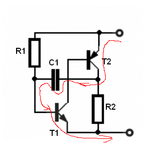

This simply multivibrator is nothing more then two stage CE amplifier with positive feedback add by C1 capacitor.
https://www.physicsforums.com/attachment.php?attachmentid=62319&stc=1&d=1380546342
When we first start-up the circuit C1 start to charge until T1 start to conduct.
The current that is flow through T1 also opens T2 transistor. T2 collector voltage reach positive saturation voltage (4.5V). And C1 capacitor will quickly charge in the circuit:
+4.5V ---> emitter-collector T2---> C1 --->base-emitter T1--->GND
The capacitor is rapidly charge to V_C1 = Vcc - Vbe - Vce(sat) ≈ 3.8V.

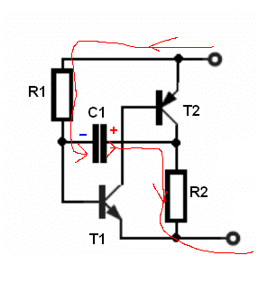

And when Capacitor is full charged. The T1 base current is provided by R1 resistor. And
in order to circuit work as a multivibrator we need to select R1 so that R1 current is so small, that T2 immediately after C1 is full charging comes out from saturation to the linear region.
So voltage on T2 collector is start to drop (T2 comes out from saturation). This change in VecT2 voltage is "feedback" by C1 capacitor to T1 base.
This will decrease the voltage at T1 base. So T1 and T2 will decrease his currents. This will increase VecT2 and Q1 base voltage drop even faster (for example if Vec = 0.3V then Vb = Vcc - Vec - Vc1 = 4.5V - 0.3V - 3.8V = 0.4V).
So C1 that was previously charged to 3.8V "pulls-down" the voltage on the T1 base below GND (-3.8V)
So we have a very strong positive feedback in this circuit.
So T1 and T2 will be immediately go into cut-off.
And C1 immediately start to discharge in the circuit:
right C1 plate ---> R2 --->battery--->R1----> left C1 plate.
The voltage on the "left" plate of a C1 is rising during discharging phase, at some point becomes equal to zero volts (end of discharge), and voltage at C1 "left" plate (at T1 base) will continue to rising (C1 is now charging).
When voltage on C1 will increase to 0.6V the T1 is start to open.
And we buck to the beginning.
