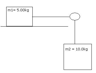

2. An object with mass m1 = 5.00 kg rests on a frictionless horizontal table and is connected to a cable that passes over a pulley and is then fastened to a hanging object with mass m2 = 10.0 kg. Find the acceleration of each object and the tension in the cable.

Draw free-body diagrams! Label all the forces.
1. What is the definition of the normal force? What do you need in order to find it?
For the rest of these, you really must draw free-body diagrams. They let you see what's really going on.

This is for number 2. Is this the kind of thing you're looking for?
Not quite. Draw each block separately, and draw all the forces that act on the block as arrows in their respective directions.
Okay, I have solved number two: a) 6.54 m/s^2 and b) 32.7 N.
