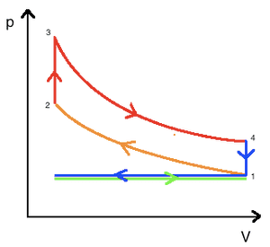

It means that you can execute a process doing work, while starting and ending at the same state.
Consider for instance a combustion engine.
It makes the following so called Otto cycle:
During the cycle a number of transitions are made, beginning and ending at the same p-V point, which is the same state.
However, since the path through which work is done, has an enclosed surface, the work done is not zero, but an amount that depends on the path.
