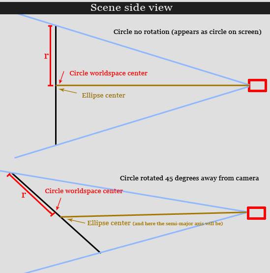

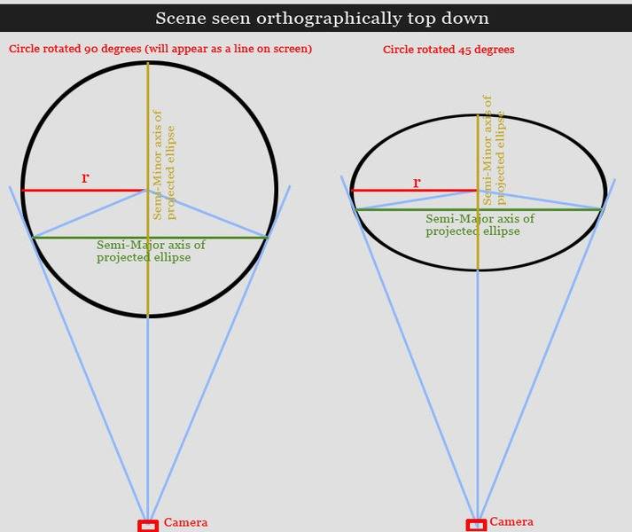

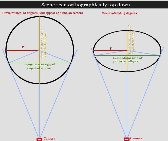

Thanks for the answer! I just did some pictures to visualize a problem with your solution. Unless I misunderstand.
The semi-major axis, or the vectors pointing towards them, doesn't represent the diameter of the circle. If I calculate at what distance I have a circle radius between one of the max points on the semi major axis, and the center of the ellipse, I will calculate a distance too short, because the angle is a little too wide. As the circle rotates aways from you, the semi major axis, if projected onto the circle in world space, will lie between the two tangent points of the circle (or ellipse) as seen from above, which intersects the camera. And as I don't know the distance to the camera, I can't calculate those two points. And I can't calculate the distance without them either. Or maybe I can. I'm simply not skilled enough ;)
My next approach is to drop the semi major axis max points all together, and instead find the actual points on the ellipse, which represents the diameter of the circle. This should be fairly easy. I know the circle center on screen. I know the center of the ellipse. The distance between those two could be used as my y-value, and then the x-value should be calculated. That would give me two points on the ellipse, which, if I shoot vectors at them, and measure the angle, could give me the distance to the circle center. When that is done, I'll look into your solution! It looks valid from then on.
