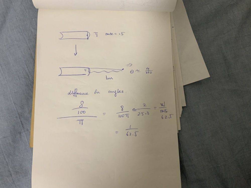

How far did you get on this problem?
not far at all i was trying to compute the area raito btwn when it is at the end of the tube and far away. but my answer comes nothing close to the choices below
You'll have to provide an attempt at a solution to get help.

How are you using the bit about 50% being detected when the detector is placed against the face?

Please show these calculations, otherwise we can't tell what went wrong.
The solid angle is not proportional to the subtended angle. Rather, it relates to the area of the spherical cap of a sphere centred on the source, the cap spanning the aperture.
When the source is in the centre of the aperture, radius r, the end cap is a hemisphere of area ##2\pi r^2##. Dividing by the area of the whole sphere we get ##\frac{2\pi r^2}{4\pi r^2}=0.5##.
With the source at distance d from the centre of the aperture, the whole sphere has area##4\pi (r^2+d^2)##. The endcap's area has shrunk to not much more than ##\pi r^2##.
However, I am uncertain how the 8cm length fits in. If it is relevant then I don't understand how it can capture 50% initially.
I'm sorry, but if that's your attempt of a solution, you are not ready for graduate school.
Your picture isn't labeled and your variables aren't defined.
You have expressions involving numbers, but no sense of what they are, where they come from, or where you are going with this.
If this is how you solve problems, when you get to Jackson or grad QM, you won't make it out the other end.

I just solved the problem with two l

Thanks to you I solved it with 1 line of math
