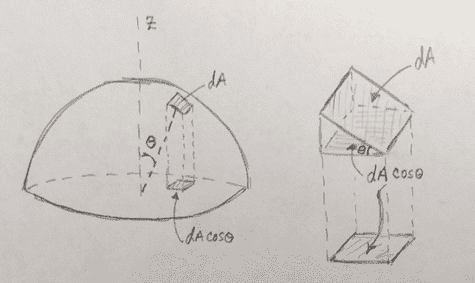

Spherical coordinates are the natural coordinates for doing the integration. However, you can avoid having to do any integration by giving a geometrical interpretation to ##dA\cos \theta##. The figure below shows how to interpret this as a projection of a patch of area of the sphere onto a horizontal surface. So, summing all the ##dA\cos \theta## for the hemisphere is the same as summing all the horizontally projected areas. The sum of the projected areas is seen by inspection without having to perform an integration.
Yes Thank you for the answer and the diagram really explains the thing.
The limits for the integration would be ##0 \to \pi/2## right ?
Yes, that would be the limits for ##\theta##.
