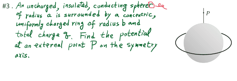

I don't really understand how to find the solution. I've tried to find the solution in books and google but still can't find it. In general, the Question 1 the problem is using the method of Image charge and Induced surface charge density. but this time my professor changed it to something else. can you guys help me? Thank You.

Which books have you searched for a solution to problem 1?
But you can do this exercise by noticing the boundary condition: ##\varphi=0## on the sphere and ##\varphi=0## at infinity; and plugging the Zonal Spherical Harmonics.

I'm not sure which book I read, because I just googled it. and I found some questions that are very similar but only different methods are used.
but I still don't understand how I plugged the Zonal Spherical Harmonics into it :cry:

At ##r=R## you get ##\varphi(R,\theta)=0##, plug ##r=R## into the Zonal Spherical harmonic and equate to zero. For ##\varphi(r=\infty,\theta)=0##, notice that only ##P_0(\cos\theta)## contribution here, since there's no dependence on ##\cos \theta## in the boundary conditions.
