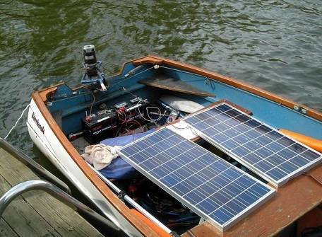

Yes that's my freakin solar powered boat... Do you think I could make this stuff up?
Can I do that and still connect all the batteries in serie to supply the 96 volts needed?
I don't see the motor...
Is that an advanced DC motor, about 8 HP ?? Nice rig!
Now I know what I can do with that old Chrysler foot that has been laying in my back yard for 17 years:biggrin:
:frown:
1(?) hp 12(?)vdc pride wheelchair broken(free!) motor that I fixed in about 15 minutes.
