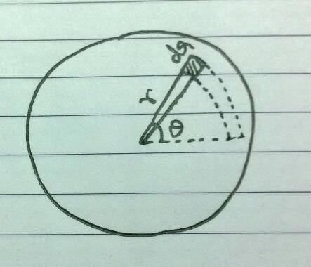

In second case, for any disc, I will take a small element of area ##rd\theta dr## at an angle ##\theta## from horizontal.
The mass of this element is ##dm=Ard\theta dr##
Here A is Mass per unit area
Torque on this section is ##d\tau=r.\mu g.Ard\theta dr##
$$\tau=A\mu g\int_0^{2\pi}\int_0^Rr^2drd\theta$$
Let the upper disc be smaller than lower disc.
Total torque on upper disc is ##\tau=\frac{2\pi\mu gA_1R_1^3}{3}##
For the lower disc, its ##\tau=\frac{2\pi\mu gA_2R_1^3}{3}##
(Since friction acts only till ##R_1## for the bigger disc)
For torques to be equal, the mass per unit area has to be same.

No, that's not what I meant.
In each case, what external forces and torques might act on the system consisting of the pair of discs?
In the first case, there are hinge forces on the disc. In second case, friction does not act in a single direction. The hinge force is zero.
In both cases, only friction causes torque.
Forces from the axles, yes.
True, but that's internal forces.
Titan97 said:
In second case, ...The hinge force is zero.
Yes.
No. If that were the case a.m. would be conserved in both.
The point is that in the first case there are two axles, with a nonzero linear force exerted by each on the system. The two forces are equal and opposite, but exert a net torque on the system regardless of what axis you choose for taking moments.
