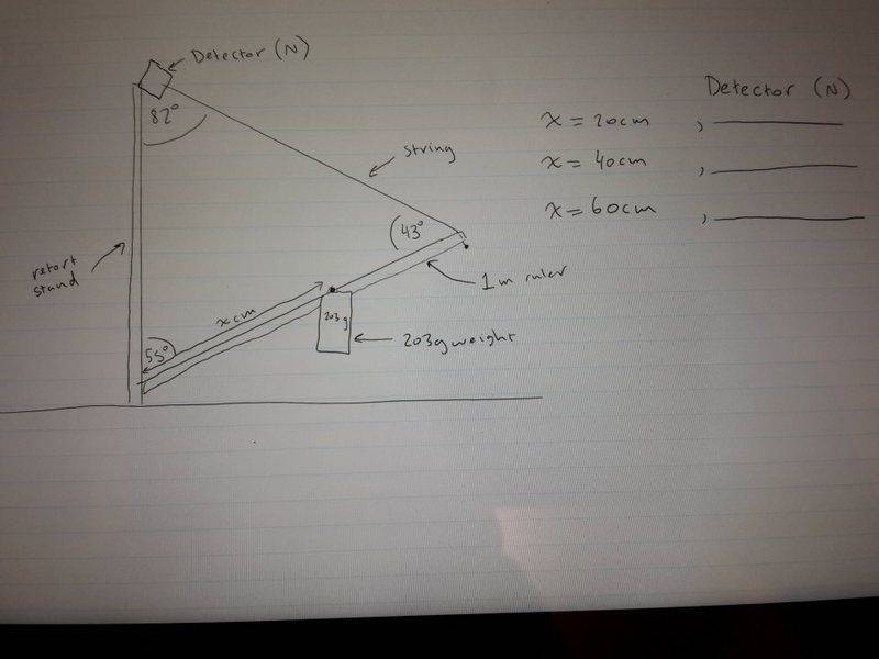

Here's a diagram of what I'm talking about: http://i.imgur.com/irgHuqq.jpg
Basically, the only variable altered is the value for x. I tried googling for hours now, have read everything in my book relating to this topic, I still have absolutely no clue how to answer this. I tried studying sites like these: http://hyperphysics.phy-astr.gsu.edu/hbase/torq2.html and these http://www.wikihow.com/Calculate-Tension-in-Physics, I still am no closer to knowing how to figure out this specific problem.
Can you please give me the answers for those 3 values and show me how you did it?
Thanks

If you look at the picture you can see that the force read by the detector is the question, at three different positions of the load. And the detector reads the tension in the string, that is you have to figure out. And the ruler is pivoted about the point A. Was there no mass given for the ruler?
Draw the forces acting on the ruler and find their torques about point A. The sum of the torques must be zero, as the set-up is steady. You can determine the tension from that condition.

So, you have an axis at the lower left of the diagram. You need to consider one force at a time. Start with the weight of the ruler. Through what point does that act? How far is that from the axis? What is its magnitude? What is its direction? What is the angle between its direction and the line joining it to the axis?

Right. So we have a force F magnitude Mrg, a distance from axis which we've yet to pin down, and the angle between them. Once you have the distance you can apply ##T=rF\sin(\theta)## to find the torque due to the ruler's weight.
After that, we can move on to the hanging mass.
Ok, so:
F=1.63N
r=0.2m
sin(θ)=sin(55)
Therefore:
T=(r)(F)sin(θ)
T=(0.20)(1.63)sin(55)
T=0.267N
That is, the force that the ruler, alone, exerts on the string, right? Now for the main part that confuses me, how to take into account an added mass somewhere along the ruler? this is the crux of the problem, for me.

yes, treat the weight of the ruler as acting through its centre, so r is only .5m.
You now have all you need. You can calculate the torque from the ruler, and apply the same methods to get the torque from the hanging mass and from the cable. Combine them into one equation, and out will come your answers.

You've found the torques due to the weight & ruler. We know the sum of the torques must add to zero so we can say:
∑T = 0 = Tweight + Truler +T*string
(* T for torque, not tension)
If we choose clockwise to be positive, Tstring is negative as it is anticlockwise (We could also choose anticlockwise to be positive and reach the same answer)
so we can rearrange to give:
Tweight + Truler =Tstring You've calculated Tweight and Truler so you already know the left hand side. And we know T = Frsinθ so:
Tweight + Truler =Fstringrstringsinθstring The only unknown is Fstring. So we can rearrange and solve for Fstring, then plug in the numbers three times for the three different Tweight values.

Would it be Tweight + Truler =Fstring(1.00)sin(43)?
If so, wouldn't that just give the torque of the string? How then, will I convert that to force in Newtons?
Edit: ignore that. I hallucinated and thought the F was a T (lack of sleep). So, that's it? That'll give me the tension in the string? Nothing more left to do? And the values are 1.00 and 43...right?

So, for example 60cm, would be:
1.646=F(1)sin(43)
F=2.41N or 2.41Nm-1

As I keep pointing out, torque is not force. If your force has units of N and distance has units m then torque has units Nm, Newton-metres.
So torque/distance has units Nm/m=N.
So... the answer is 2.41N for 60cm?

I thought billy had confirmed that, but I see it was not explicit. Yes, the answer looks right.
