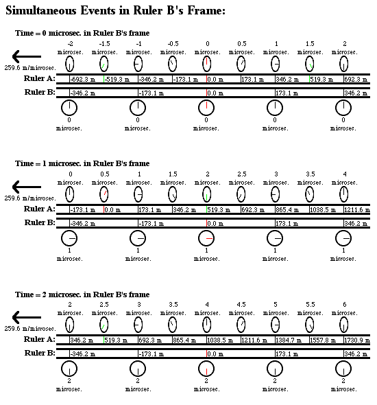

Oops, I did indeed miss this one.
cfrogue said:
Now, when the center of the rod is at the origin of O, all clocks are synchronized to 0 in each frame.
Look at the https://www.physicsforums.com/showpost.php?p=2464800&postcount=88" again, note that the lines t=0 and t'=0 intersect only at the origin. You cannot synchronize all of the clocks in each frame, you can only synchronize one clock in each frame. The relativity of simultaneity requires that all of the remaining clocks be out of sync between the frames.
I suspect this is just a communication problem and that you understand that already.
  • #234

  • #235
DaleSpam said:
Oops, I did indeed miss this one.Look at the https://www.physicsforums.com/showpost.php?p=2464800&postcount=88" again, note that the lines t=0 and t'=0 intersect only at the origin. You cannot synchronize all of the clocks in each frame, you can only synchronize one clock in each frame. The relativity of simultaneity requires that all of the remaining clocks be out of sync between the frames.
This diagram does not address the many different origins.
Why??
If it does not, then it is incomplete.

  • #240
It does.
Observe the intersection of the light cone with the line t=1. This is the unprimed light sphere at t=1. Observe the intersection of the light cone with the line t'=1. This is the primed light sphere at t'=1.
Note that the midpoint of the unprimed light sphere is on the line x=0. Note that the midpoint of the primed light sphere is on the line x'=0. As you can see in the diagram, the two different light spheres have two different centers.
  • #241
DaleSpam said:
It does.

cfrogue said:
I did not see you put these light spheres at an origin. What is the origin?
Look at the diagram:
This diagram is drawn from the perspective of A's frame, with A at rest at the origin of this frame...the horizontal axis is x and the vertical axis is t, so you can say that A's position on the horizontal axis is x=0, and the light is first emitted from this position at t=0. B is at the origin of his own frame, at x'=0, and the tip of the light cone where the light was first emitted is also t'=0. You can see that for A, the light sphere at the moment of the event E on the left also contains the event E1 on the right, and that A is exactly midway between E and E1 at the moment these events occur. You can also see that for B, the light sphere at the moment of the event E on the left contains the event E2 on the right, and that B is exactly midway between E and E2 at the moment these events occur (according to his own definition of simultaneity). You can look at the graph to find the coordinates of all these events if you want to check the math--for example, in the A frame E occurs at (x=-2, t=2) and E2 occurs at (x=6, t=6), while the event on B's worldline that is simultaneous with these events in his own frame occurs at (x=2, t=4). If you apply the Lorentz transformation to all three of these events (using v=0.5c), you find that in B's frame they all happen at the same t' coordinate, and that the event on B's worldline occurs at x'=0 while E and E2 happen at equal distances from B on either side.
cfrogue said:
OK, does time dilation not apply?
Please explain why.
I am glad to see you knew what I was doing.
But, you will now need to support time dilation.
It does apply. Because of the relativity of simultaneity, if the clock at the left end of the rod reads 0 at t'=0 in the rod's rest frame, in frame O it does not read 0 at t=0, instead it already reads rv/c^2 at t=0. So, if in frame O the clock ticks forward by t/gamma = r/(gamma^2*(c+v)) in the time it takes the light to reach it, as predicted by the time dilation equation, then the time it will show when the light reaches it will be rv/c^2 + r/(gamma^2*(c+v)).
With a little algebra we can simplify this:
rv/c^2 + r/(gamma^2*(c+v)) = rv/c^2 + r*(1 - v^2/c^2)/(c+v) = [rv*(c+v)]/[c^2*(c+v)] + [rc^2*(1 - v^2/c^2)]/[c^2*(c+v)] = [rvc + rv^2 + rc^2 - rv^2]/[c^2*(c+v)] = [rc*(c+v)]/[c^2*(c+v)] = r/c.
So, taking the initial time on the rod clock at t=0 in frame O (which is not zero due to the relativity of simultaneity) and adding the elapsed time in frame O predicted by the time dilation equation yields the correct prediction that the clock will read r/c when the light reaches it.
  • #243
It does apply. Because of the relativity of simultaneity, if the clock at the left end of the rod reads 0 at t'=0 in the rod's rest frame, in frame O it does not read 0 at t=0, instead it already reads rv/c^2 at t=0. So, if in frame O the clock ticks forward by t/gamma = r/(gamma^2*(c+v)) in the time it takes the light to reach it, as predicted by the time dilation equation, then the time it will show when the light reaches it will be rv/c^2 + r/(gamma^2*(c+v)) = rv/c^2 + r*(1 - v^2/c^2)/(c+v) = [rv*(c+v)]/[c^2*(c+v)] + [rc^2*(1 - v^2/c^2)]/[c^2*(c+v)] = [rvc + rv^2 + rc^2 - rv^2]/[c^2*(c+v)] = [rc*(c+v)]/[c^2*(c+v)] = r/c.
Uh, does that mean that time dilation is false?
