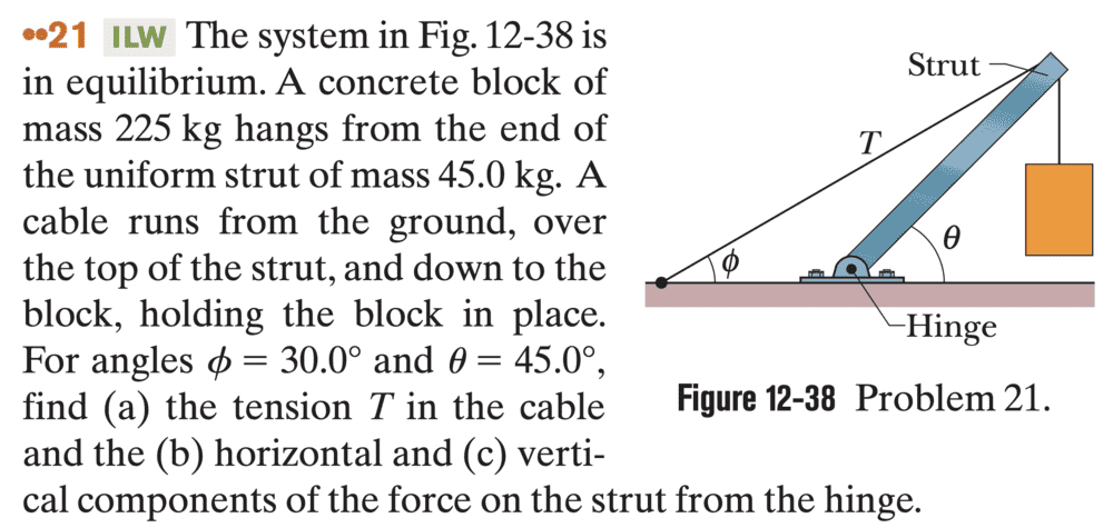

See image for question from: Fundamentals of Physics - 10E - Page 346 - Chapter 12 - Problem 21 (YouTube: y2u.be/ZY3-ZSQP1Mo).
For Part A, I was able to figure out the τ components around the hinge and solve for T. The τ parts are mostly intuitive for me in these problems.
Parts B and C confused me (though I solved them with YouTube help (see above)).
I'm having trouble developing intuition around ΣF=ma=0 in statics. Specifically, with regards to Normal or Reaction Forces.
My explanation for Parts B and C right now is:
Since the strut is not rotating (Στ(strut's bottom) = 0), all those forces on it will be directed down the strut and towards the hinge.
In this case, the downward Fg(block), Fg(strut), and the downward component of the T are all pushing down on the strut which is pushing into the hinge. The hinge responds with an equal force in the opposite direction (upward). So, we have no translational motion in the y direction.
The horizontal (-x, left) component of the T travels down the strut and tries to pull the hinge leftward (-x), but, once again, the hinge responds with an equal force in the opposite direction (rightward, +x) and so, we have no translational motion in the x direction.
Is this correct?
Does anyone have a more intuitive explanation or something I could watch or read to develop my intuition here? I know that not everything in physics has intuitive explanations but it's worth a try.
It just baffles me that I don't have to consider how far the block is from the hinge/strut connection when doing ΣF=0.
If a system is and remains at rest, the acceleration of its center of mass is zero. What is there to intuit?
Since the strut is not rotating (Στ(strut's bottom) = 0), all that force has to be re-directed somewhere.
All what force? The net force on the CM (we established) is zero. The equation ##\Sigma \tau = 0## says that the angular acceleration about the system's CM is zero. So we have two things happening simultaneously (a) the translational state of the CM is not changing and (b) the rotational state about the CM is not changing.
Is this correct?
The best way to think about it is that all the forces involved (except gravity) will adjust themselves to provide zero linear and angular acceleration. That's what they will do if you move the hanging mass to a different position on the strut or the point where the cable is attached on the ground. Don't worry about where the forces "go". They don't go anywhere. Being contact forces, they adjust themselves to provide the observed accelerations which are zero.

A step before that is to be clear how you are partitioning the system into subsystems and draw a free body diagram for each.
Next, identify the reactions between subsystems in contact. (A common blunder is to include forces from a subsystem that is at a second remove.). In this, consider whether there may be a torque in the reaction; if it is a free joint there will not be, but otherwise there might.
Then, for each subsystem pick your axis for torque analysis.
Now you are ready to write down the torque balance equation and pair of force balance equations for each subsystem.

So, back to the original problem:
My initial intuition was that some fraction of the forces at play were being "used up" to ensure that net torque remains at 0. It seems that I was wrong about the "used up" part.
It seems that once the net torque is locked in at 0, the translational forces come directly into play and in the problem given: they also cancel out in every axis and equal to 0.
For example: For the hinge to provide an upward normal force on the strut, it must first be locked in (net torque about it must equal to 0).

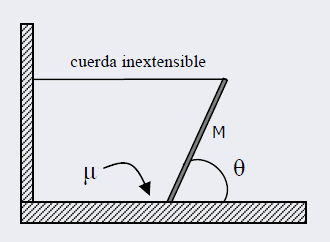

Take this mind twister:
L = length of uniform rod
m = mass of uniform rod
μs = coefficient of static friction
T = tension in cord
Fn = normal force from ground on rod
fs = static friction (directed right, +x)
Στ(bottom of rod)=0
+LTsinθ + - (L/2) mgsin(90-θ) = 0
T = (1/2)(mg) [sin(90-θ) / sin(θ)]
ΣFy,system=0
-mg + Fn = 0
Fn = mg
ΣFx,system=0
-T + fs = 0
-T + (μs)(Fn) = 0
(μs)(Fn) = T
Does this make sense?
It does not make sense. Your last line (μs)(Fn) = T conflicts with what you got from the torque equation
T = (1/2)(mg) [sin(90-θ) / sin(θ)]. Just look at the drawing, the sum of the horizontal forces is zero which means that##f_s=T=\frac{mg}{2\tan\theta}~~~\left(\sin(90^{\text{o}-}\theta)=\cos\theta\right)##. The force of static friction is what is necessary to provide zero acceleration in the horizontal direction; ##\mu_sF_n## is the maximum value it can have. Also, this mind twister is a different problem and I don't see what it has to do with the original question.
Finally, I don't see what you mean by this
The hinge will provide an upward normal force whether the torque is zero or not. If you cut the cable and the strut accelerates down, the hinge will still provide an upward force. If it didn't, the strut would sink into the ground. You are looking for causal relationships where there aren't any.
Likes lightlightsup
lightlightsup said:
-T + (μs)(Fn) = 0
Only if we are told that the system is on the point of slipping. More generally, ##|f_s|\leq\mu_s|F_n|##.
Other than that, your analysis looks right.
I wouldn't agree with your first "locking in" forces via torque balance view; you could equally think of locking in via linear force balance first. The equations operate simultaneously.
Likes lightlightsup
