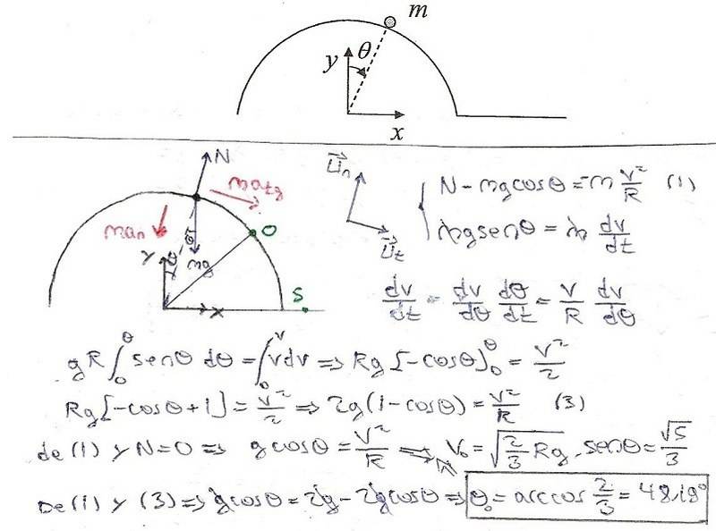

A particle of mass M is on the top of a vertical circle without initial velocity. It starts to fall clockwise.
Find the angle with respect to the origin, where the particle leaves the circle.
v=ωXr
I used two unitary vectors..
εr : which direction is the same as the line described by the radio in the separation point.
εθ: perpendicular to εr (the direction of the tangential velocity in the separation point)
r=R er
v=dr/dt = Rder/dt
v=ωXr (counterclockwise, so I changedthe sign to negative)
v=-R(ωXer)
v = -R(-ω) = ωR
α=dω/dt
a = dv/dt = R(α + ω d/dt)
d/dt = -(ωX) = -ωer
a = α R - ω^2 R er
Forces:
Weight, Normal force
Centripetal is a resultant?
F(eθ)==> mgcosθ = αRm
F(er)==> N-mgsenθ= -ω^2Rm
So:
α=dω/dt= (dω/dθ)(dθ/dt)=ωdω/dθ
θ
∫αdθ =
∏/2
ω
∫ωdω
ω0
From F(er) : α= (gcosθ)/R
θ
∫ (gcosθ)/Rdθ = (gsenθ)/R
∏/2
ω
∫ωdω= (ω^2)/2
ω0ω^2 = (2gsenθ)/R
I come back to the force equations, (with zero normal force) and replace ω^2
And I get nonsenses like 2=1. Did I do something wrong?
Solution: 48,19º (by the teacher)
Zipi Damn said:
θ
∫αdθ =
∏/2
ω
∫ωdω
ω0
Not sure exactly where, but you have a sign error. The first integral will be negative, but the second positive.
θ
∏/2
You've not filled in the 'lower' bound correctly after integrating.
ω^2 = (2gsenθ)/R
Could have got this much more quickly and reliably by conservation of energy. Note that the RHS should be 1-sin, not sin.
I found it solved.
