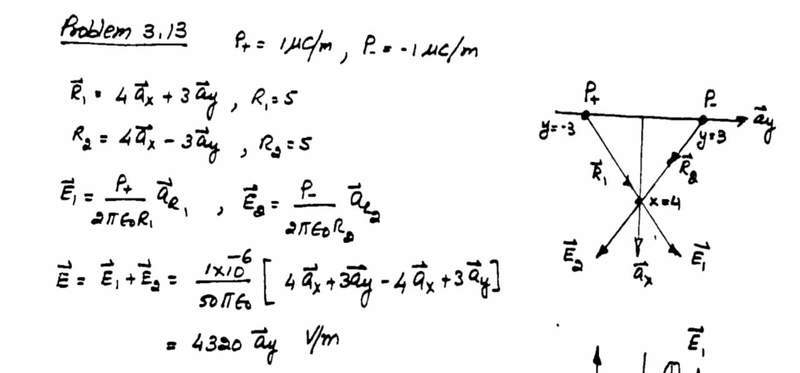

Looking at the picture I have attached the problem is very straight forward. In the denominator of the equations I have posted the teacher uses 2[itex]\Pi[/itex] but the book uses 4[itex]\Pi[/itex]. Can someone please explain to me why is that.
Book's equation:
Teacher's Soln:
Please refer to attached pictures.

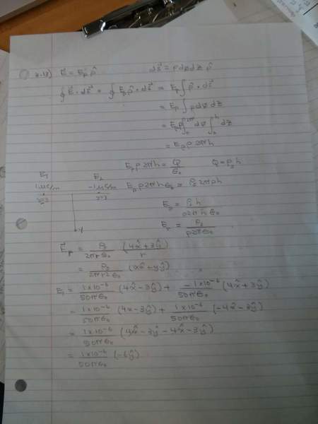

I was finally able to solve my problem. By the way from the two y points there is infinite line of charge in the z-axis. Here is my answer:
