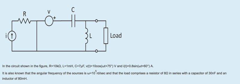

1. Homework Statement
There are multiple parts to this question, but I have only got through the first 2 before getting stuck. Please could somebody give me a hand as I am really struggling :frown:
(a) Calculate the phasor voltage of the voltage source and the phasor current of the current source in both Cartesian and Polar coordinates. Use peak values when calculating the phasors.
(b) What are the phasor voltage and impedance of the Thevenin equivalent circuit of the power supply? (Use peak values for the voltages and currents in your calculation)
(c) What are the phasor current and impedance of the Norton equivalent circuit of the power supply? (Use peak values for the voltages and currents in your calculation)
(d) At what frequency should the circuit operate for the current flowing through the load and the voltage across it to be in phase?
(e) It is known that for a different load the voltage and current across the load are 240cos(ωot+45°) V and 4cos(ωot+60°) A, respectively. How much power is dissipated in that load?

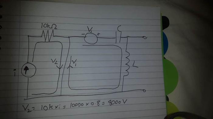

Ok, I've used the value of the modulus of the current (0.8A) to work out the voltage from the current source and resistor in series.
That worked out to be 8000V. As the voltage source is only producing 10V this seems a little off.

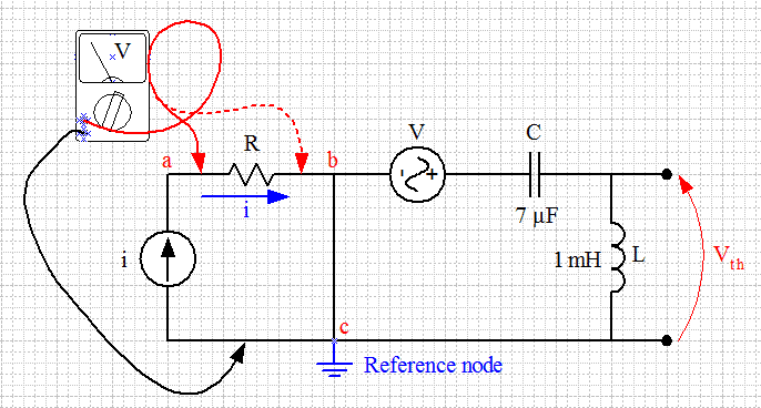

Yes, but do you care at all about the voltage drop across the resistor? Where does this 8000 V potential occur in the circuit? Sketch it in on your circuit diagram. If you were to connect the negative lead of a voltmeter to the common reference node (the bottom rail), where would you place the positive lead to read this 8000 V potential?
Likes gracy
This is my circuit diagram for now. I've put the 8000V opposing that of the voltage produced by the voltage source. Is this correct? Or should it be flowing in the same direction.
What you've labeled as V1 and V2 are currents, not voltages. Voltages (potential changes) occur across components (between nodes), currents flow through wires and components.
Your 8000 V potential change occurs across the resistor R. At which end of the resistor would you read 8000 V if you were to connect a voltmeter lead to it (with the other lead connected to the assumed reference node at the bottom).
What readings would you expect at the points labeled a, b, and c?

Ah of course, my mistake!
At a I would expect 8000V, but at b and c I would expect 0
Yes! :smile:
So, does that make your task simpler?
So the voltage produced by the current source and resistor in series doesn't affect the voltage produced by the voltage source
Right. The short circuit effectively divides the circuit into two independent circuits, isolated from each other.

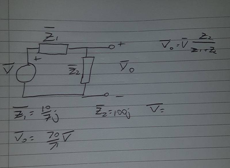

I used the voltage divider equation to get a value of (70/71)*V for Vo.
I then multiplied the cartesian form of V (2.5882 + j9.6593) by 70/71, which gave 2.5517 +j 9.5233
Am I mean't to use (Z1*Z2)/(Z1+Z2) to find ZT, rather than just adding them?
Can you show your voltage divider work in more detail?
Yes. Look how those components are connected to each other when the voltage supply is shorted.
