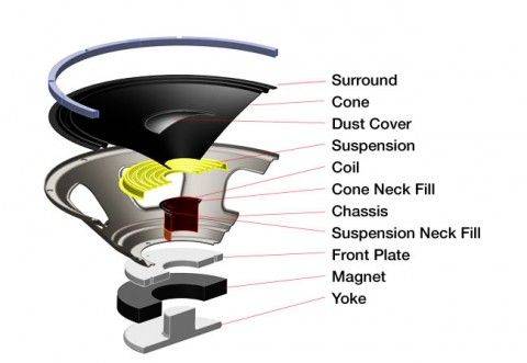

Hello everybody, I am trying to figure out how to build an electro magnetic generator.
I was wondering if an audio transducer such a speaker could act as a EMF generator, when the paper woofer is removed and the device connected to a function generator and an amplifier, in order to play the signal with the magnet only.
Would it be the same thing?
You already have a function generator and an amplifier, so you can generate an AC EMF using these.
The windings in a speaker voice coil will generate a magnetic field, same as any coil. The speaker coil is suspended near a permanant magnet, so it can move when the fields of the coil and magnet interact.

A speaker is one form of electric motor, it makes electrical energy into motion using magnetic principles.
that i understood, if you meant the paper 'cone'.
and the device
What device? The voice coil or the speaker suspension?
HH-loudspeaker-parts.jpe
connected to
Connected how? Mechanically by perhaps a spot of glue to dust cover, or electrically by wiring to the terminals?

My plan is to reproduce a waveform thru a software, the audio output will go out of the soundcard to the input of a tripath audio amplifier, in order to be reproduced by a coneless speaker using banana plugs. I was wondering if a speaker voice coil would generate a magnetic field same as any coil ?
This answers my question. Thank you! :thumbs::smile:

A loudspeaker coil is not what you want if you want to produce varying magnetic fields. A voice coil is made specifically to operate in a strong magnetic field and uses the motor effect. It has a very few turns and is light enough for it vibrate and move the cone. You do not want this; you need to produce a decent field from your coil. You will need many turns of wire for this. When you have found out the sort of field you will need then you can start to specify the required system. Approaching this with random stuff, connected together, will not achieve anything but wasted time.
People are not frustrated by your lack of technical knowledge. They are frustrated because you are not asking answerable questions. In your last post you seem to be confusing the production and detection of magnetic fields. What is it you want to do, exactly?
