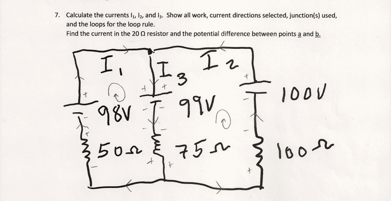

i1+i2-i3=0
50i1+75i3=1
100i2-75i3=1
matrix A=1 1 -1
0 100 -75[/B]
50 0 75
matrix B= 0
i1= -6ma
i2= 23ma
i3= 17ma
My instructor gets i1= 6ma, i2= 3ma, i3= 9ma. Please advise!
Your diagram does not show the 20 Ω resistor mentioned in the problem statement. Nor does is show points a and b.
Are you sure that this diagram fits the described problem?
Sorry, we were told to omit that line.
Check the signs of the terms in your KVL equations. Can you show some detail in your solution to the simultaneous equations? Are you using some software to solve them? Typing out a matrix doesn't tell us anything unless by some strange coincidence we happen to know what software you have and we have it too.
I am using a TI 83+. Matrix A is a 3x3 and matrix B is a 3x1. A^-1*B. I have checked my signs many times so if they are wrong I am not seeing it.
Write out your KVL equations again without combining the voltage terms or transposing the voltage terms to the RHS of the equation (so the RHS should be a zero). Say which direction you are "walking" around the loop and whether you are counting potential drops as positive or negative quantities.
-50i1-75i3-1=0
100i2+75i3-1=0
i1+i2-i3=0
We were taught to place charges at each side of each component and the charge on the side you are exiting is the sign you use for your equation. The stuff I see online is a little different in terms of drops and gains. Not sure which to use?
Okay. Those equations look correct. What values do you find with those equations?

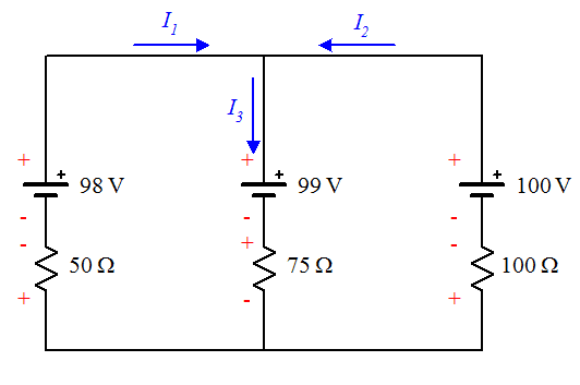

Your circuit diagram is confusing because the potential drops that you've indicated for the resistors don't appear to obey the chosen current directions. For example, I1 is flowing upwards through the 50 Ω resistor but you marked its potential change as higher where the current exits the resistor (at its top).

Here's your circuit re-drawn with appropriate potential changes indicated:
If you do a KVL walk clockwise around the loop on the left starting from the bottom left corner you encounter:
##-50 I_1 + 98 - 99 - 75 I_3 = 0##
##-50 I_1 - 75 I_3 - 1 = 0##
Can you do the same for the second loop?
75i3+99-100+100i2=0
100i2+75i3-1=0
Not sure why the 75 ohm resistor doesn't have the signs opposite what you show. Wouldn't the top side be negative from the 99v source above it?
Look at the direction that you've chosen for I3. It flows down through the 75 Ω resistor, hence the potential drop in that direction.
Ok. Now I get it. My current direction determines polarity!
