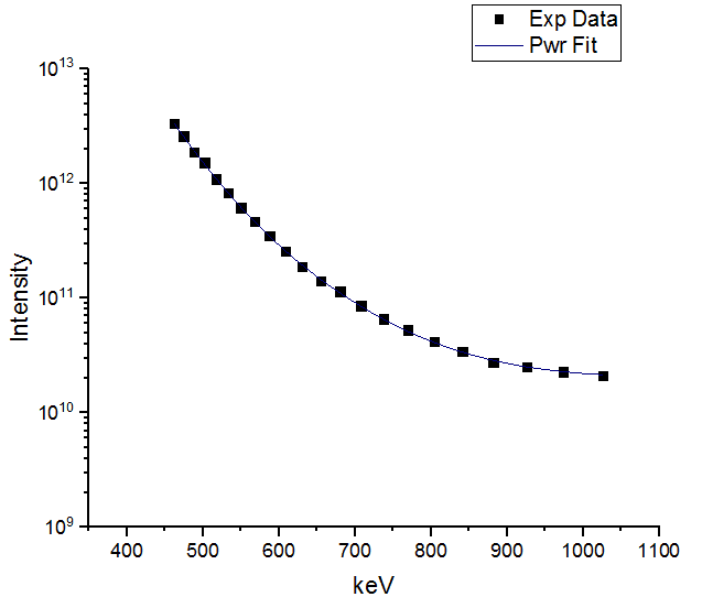

capacitor discharge in a gas produces ions. these ions are measured by magnetic spectrometry in which particles pass through the magnet and curve according to their energy and form tracks on a plastic plate.
from magnetic spectrometry two types of ion spectra are obtained (not from a single discharge but from two separate discharges). the initial condition is similar for both discharges but two different spectrum are produced: one fits with power and the other with exponential fit.
what I am looking for is to guess the corresponding potential responsible for such spectra!
What is the difference?
You wrote that y is a number of ions and x is an energy. Does that mean y of the ions have energy x? If so, is that as a histogram, i.e. y is a count of ions in some energy range around x?
Just how good is the fit? How many datapoints? What value of n do you get?
Can you post the data in machine-readable form?

497
504
692
920
708
573
198
710
